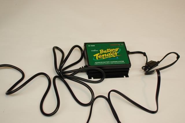

I used a Battery charger /tender that has a 12V 5amp output. I used it to power all of my lights, fan, etc. until I eventually added a battery and then used it to charge my battery when plugged in. I cut off the 12 V ends and wired them to terminal strips off my fuse panel.

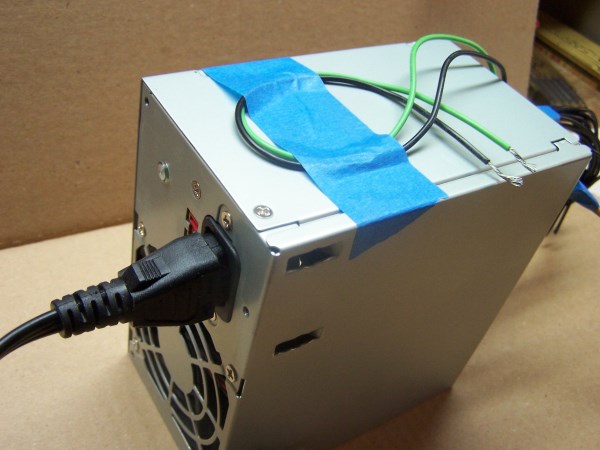

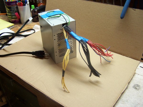

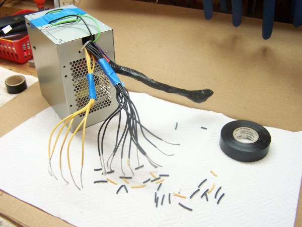

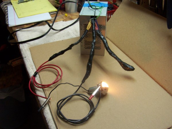

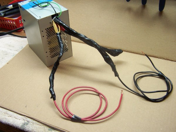

I decided to go with the computer power supply since I had several old desktop PC's sitting around in retirement. They use a 250 watt power supply that is rated 14 amps at 12 volts DC. It is really a simple process to convert one of these to a DC power source. There are about 30 wires coming out of the unit and all the black wires are grounds. The +12 volt wires will all be the same color (in my case they were yellow). There is only one green wire and it is used to turn on the power supply. All the other wires carry different voltages. The whole conversion concept is to bundle all the black ground wires together and all the positive 12 volt wires together and use their collective capacities for the 12 volt power source. The green wire is paired with one black ground wire and can either be permanently connected or run through a switch. I will run mine through a switch when I install the system. All the other wires are clipped, taped, and abandoned. I added about 3' of #14 black for ground and red for positive wire to give me plenty of room to arrange my circuit layout later.
Wires are clipped and segregated
Green wire paired with one black ground wire will be used to turn on the unit.
Unused wires are bundled and abandoned; black (-) and yellow (+) are stripped and ready to splice.
#14 black (-) and red (+) leads are spliced, soldered, and taped.
It works!

Battery Tender 022-0157-1 , Shop around as the price various a lot. Never had any issue with any 12 volt device I have plugged into it
