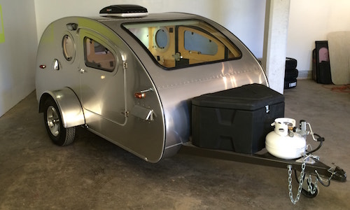

our teardrop
Vistabule teardrop.jpg (37.53 KiB) Viewed 4192 times
