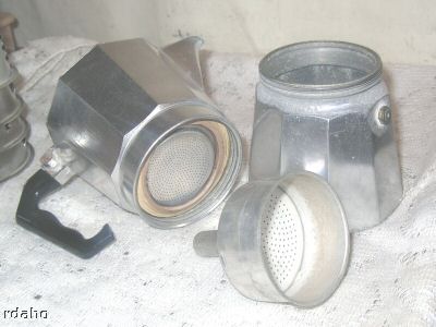

Bob and I both use the Bialetti Moka, as do millions of folks in Europe. It is small, simple, brews really fast and quite simply makes the best coffee you can think of. Depending on how you do it, you can make an amazing cup of "Cafe American" or the perfect Cappuccino. And as he said, all in about 4 minutes using almost any heat source.
http://www.amazon.com/Bialetti-Express- ... ka+express
It is called a "6 cup" not because it makes 6 mugs of coffee in the pot, but instead makes enough of the concentrated liquid to make either 6 cups of coffee when adding boiling water to the mug or 6 esspresso cups, at the nuclear level of concentration. Buy a $3 frother from Bed, Bath and Beyond and impress the heck out of the other campers by having your perfect cappuccino with foam. 8)
