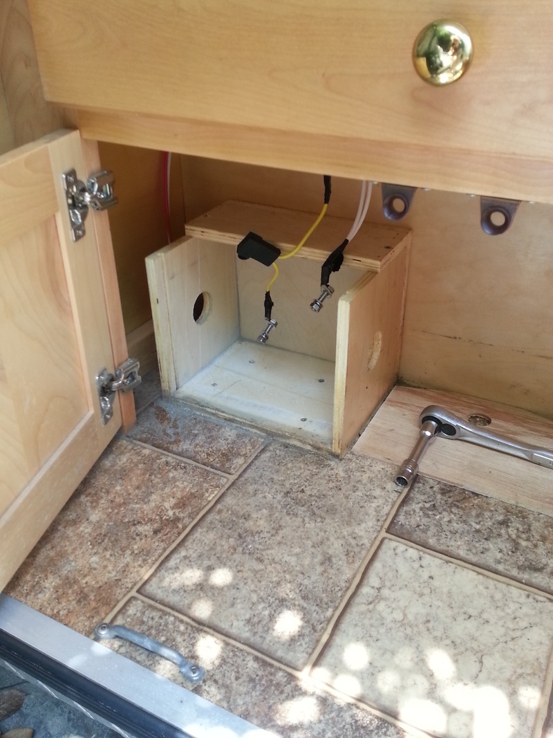

**EDIT** Ok, so I just went to measure the battery compartment size for anyone who didn't have it handy (7.5" x 5.5") and I realized how makeshift that little battery compartment is. I assume it would make since to modify that to fit a bigger battery..
silver shadow battery.jpg (238.01 KiB) Viewed 6371 times

I think that was probably a 35 amp hour AGM marine/Rv type battery: http://www.harrisbattery.com/sites/defa ... 2V35AH.pdf
You can pull about half (or a little more with an AGM) the amps out of a battery before you damage it. So that battery was good for about fifteen amps. Not much. Assuming you're running a Fantastic Vent Fan, you're drawing about 3 amps/hour.
I think I'd pull that plywood out and mount a Group 24 marine/RV battery that would give you about 40 useable amp hours. (assuming you have room) https://www.batterystuff.com/kb/tools/b ... sizes.html
You may have to go with a Group 24 AGM battery since it doesn't look like there is any venting in that space.
http://www.amazon.com/TH-Marine-BHF-24S ... ttery+base
Forget 6 volts. You're charging issues would walk if you got a mechanic to wire up that seven-prong connector.

Sounds like it's a 35AH battery. If it is, then you could get 2 of them, in the AGM type like they use in wheel chairs & run them in parallel (hot to hot, negative to negative) and have about 50 amp-hours available for power over night. The AGM battery type will run down to 20% instead of 50% like a more conventional flooded lead-acid battery. If you use a flooded battery, it should have proper venting. A sealed battery is better if it isn't vented in that space already, that's where the AGM battery shines, better cycling characteristics & no venting needed.
A small solar panel, maybe the folding type you can move (100 watts with a decent charging module), would charge things back up during the day if you aren't travelling. If you charge while towing it wouldn't take much time to bring it back up to full. Make sure your lights are the newer LED type, since they draw very little current.
This should do well for what you need, if you can do a good installation.

tony.latham wrote:I think I'd pull that plywood out and mount a Group 24 marine/RV battery that would give you about 40 useable amp hours. (assuming you have room) https://www.batterystuff.com/kb/tools/b ... sizes.html
That's correct, no venting currently. AGM sounds like the solution.

"Is there an advantage to using two 35 amp-hr batteries vs buying a single battery with similar capacity?"
No advantage, but I was thinking that the space required for a bigger battery might be an issue for you. The venting thing is important & locating two smaller batteries might be easier than one big one. It just depends on the room you have already, location & what you need. A group 24 might be better if there's room to do it. The regular wheel chair battery costs between $25 & $85 each, so if you got 2 decent ones, it might be cheaper to run the system this way.
