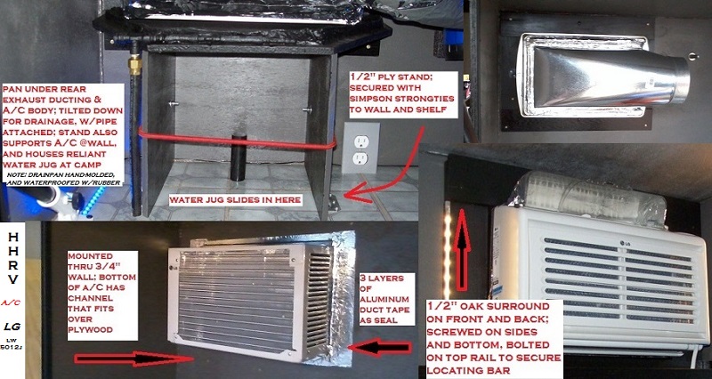

Postby working on it » Thu Sep 15, 2016 10:30 am
This is how I mounted my window shaker. The LG 5k BTU unit performs very well, does not drip (I have the drip pan jic), and actually only shakes the windows imperceptibly (solidly-mounted in the rear bulkhead). The advantage to the permanent mount inside the rear compartment is that it is secure from theft and damage, from insects and the elements, requires no effort to set-up and use, and can operate with the hatch locked for the night. I built the trailer for sleeping positioned head to the rear, feet forward, so the controls are in reach, while the airflow is circulated top-to-bottom of the trailer (cooling the hot roof first!). If needed, I use a separate fan to aid in the circulation. I've used this system in 108 degree heat, and in pouring rain. Only drawback, is the un-insulated exterior walls "sweat" in high humidity, showing a loss of efficiency, but in a 4x8 trailer, 5k btu's has plenty of cooling to spare. Image
    below Right-angle ducting vents exhaust to side vent (shields from rain).
125895110654110653108160
    below (1)LG unit with the master switch (a/c, in-line duct fan, exterior chassis cooling fan), (2)rear view with hatch open, (3)view of unit with deflector directing air forward under ceiling, (4)front shelf where airflow is re-directed back to rear by an ac-powered 3-speed fan.
108161125895106810106811
173193172890148599
