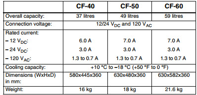

Postby RunnerDuck » Tue Aug 30, 2016 5:48 pm
Damn, I doubt that's going to happen. I still don't understand the 70 Amps in your calculation.
I was thinking with 7 Amps 10 AWG would be plenty.
By the way I was wrong about the amps at 120V. Here is the technical data sheet.

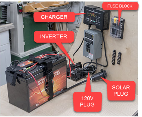

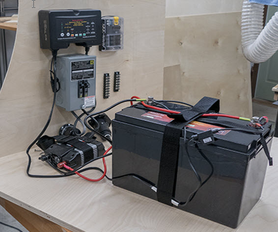

Postby RunnerDuck » Thu Sep 01, 2016 8:44 am
Here's a mock-up of my wiring panel. The 120V breaker box will feed the outlets in the TD and a separate one for the refrigerator which will run the refrigerator when on shore power but when I unplug will automatically switch over to 12V. I do believe this will work! Now I just have a butt load of wiring to do.
From the front of my tongue box:
wiring layout.jpg (60.67 KiB) Viewed 3322 times
From the back:
wiring layout back.jpg (50.15 KiB) Viewed 3322 times
Let me know if you see anything that's glaringly bad as this is my first time doing this.
Thanks,
Ken

Postby Camp4Life » Thu Sep 01, 2016 2:32 pm
FYI, that inverter looks a lot like a Black and Decker 400w inverter that I had, and it runs very hot. Mine ended up destroying my laptop's AC adapter and then quit working. Not sure if it overheated and malfunctioned or what, but I couldn't get it going again anyways and it ended up in the recycling depot.
