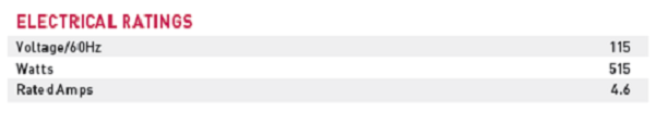

  • I have a LG LW5012J A/C, 5000 btu, and I use a Craftsman 2500W generator. It has not had any problem starting the A/C, which has a probable LRA of 1530 watts(based on examples I have read of similar starting draws). I never looked on the A/C data tag (I don't recall seeing one, but I will look tomorrow for it) which should state the LRA (starting power draw) on it. I've only used my generator three times in testing the startup, but as it has sat untended for 18 months, I need to run it again, so another full test is in order.The electrical specs:
    LG LW5012J Air Conditioner Specs.PNG (16.09 KiB) Viewed 1918 times

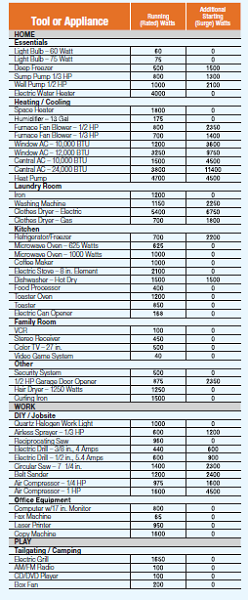

  • Interpolating the known power draw of my A/C against those on this chart:
    generator sizing.PNG (135.26 KiB) Viewed 1918 times
    shows that 1500 watts on startup is about right.

  • I looked at the tag, but the amp draw nor the peak draw (LRA) were listed, just the amps and watts during normal running conditions. As I stated before, the peak draw can be surmised from averages listed in amp & wattage charts for generators.
  • I copied a tag from a central air unit as an example of the rating system, and a wattage draw chart, modified to include the normal range of 5000 btu A/C units.
    rated amp draw definitions & sample data tags.png (343.72 KiB) Viewed 1884 times
  • To be on the safe side, of not having enough generator capacity to start the A/C from an LRA condition, I chose (actually I traded for -with a more powerful 6000 watt generator, too large to install inside my trailer- a 2500 watt peak model), that I knew would be able to surpass the A/C unit's startup requirements. Like they say, when in doubt, go big (or in my case, about 60% overcapacity).
