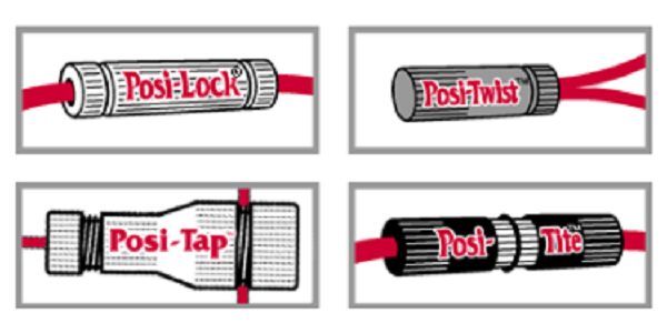

As will become clear from this posting, I am completely new to the world of automotive-style wiring. I have laid out my wiring plan (thanks mostly to the excellent store of information and guidance from participants on this website) but now I find myself confused over the simple question of wire connections. Many of my connections will not be accessible without opening walls after the teardrop is finished so I definitely want to get this right. I have read that simple wire nut connections (like home wiring) are not adequate due to loosening from vibration and potential moisture issues. Advice on marine and automotive websites suggests that soldering weakens the wire and soldered joints are subject to breaking with vibration. So I figured I would follow the general advice and use crimp and heat-seal connectors. My question is: what do you do when you need to splice more than 2 wires, as with connections for lights wired in parallel? I have seen 3-wire crimp connectors on line but they appear to be very uncommon. The PosiTap and Posi-Twist connectors (found those on line too) look like they would work, but it seems like there must be a simple solution.

I love using Posi-Lock products. I've been using the same ones, over and over, on a long line of automotive projects since the 90's. Especially underdash (back when I was still flexible enough to work there), where I found them easier to use than crimping, uncrimping, re-crimping connections as I changed components time and again. My crimps were never that good anyway, so the positive lock that Posi-Locks always provide gave me assurance that my connections were good to go. My favorite type is the original Posi-Lock,

though I've used them all. I used to carry a few in my pocket, back when I was racing, just for quick fixes (usually on other racer's cars -I also always had tubes of radiator stop-leak, though not in my pocket-). Over the last few years, I seem to have run out of them, and have been using up my stock of standard connectors, even on my trailer, so it's time to get more. I recently chased a bad lighting fault on my TTT when a crimped connection pulled loose; I replaced the crimp connector with a Posi-Lock that I found at the bottom of my truck box. Yep, time to get more (they are worth the extra cost).
Posi-Lock products.png (95.85 KiB) Viewed 2397 times
