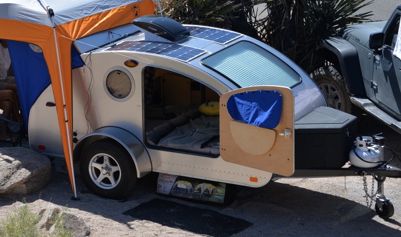

Just about finished installing what I believe may be the most advanced electrical system in a teardrop trailer. For more than 12 years the wife and I were cruising sailors. When making the switch to camping I felt it was necessary for me to have 2 things, sleep well and not sacrifice on our electrical needs. I could deal with everything else if I just had those two necessities.
The wife and I purchased a new/custom ‘Vistabule’ teardrop trailer last year. Not wanting to sacrifice anything electrical we had on the 50 foot boat and since the little teardrop was new I started from scratch and re-installed the electrical system leaving only the pre wired lights untouched.
My system consists of 2-100 amp hour Lithium Ion (LiFePO4) 12 volt batteries, a 1,500 watt pure sinewave inverter, 40 amp 120 volt charger, a high amperage feed from the Jeep alternator to the teardrop batteries for charging from the tow vehicle, Victron battery monitor & MPPT solar controller, iphone monitoring along with 2-100 watt semi-flexible solar panels (roof mounted).
We just returned from 10 days of dry camping in Joshua Tree National Forest here in Southern California and after a lot of trial and error including shorting out a Victron solar charge controller and purchasing a replacement the system is working great! We have all the power we want (at the moment, 50 amp hours in a 24 hour period) and can charge the batteries using either the 120 volt shore charger, the Jeep’s alternator or the 200 watts of solar panels. We can also monitor everything by bluetooth on our computers or smart phone. We have a refrigerator, make percolator coffee in the morning and can plug in anything that can be plugged into a household circuit at home (like a waffle iron). With our charging system we can re-charge the Lithium Ion batteries quickly with 120 or the Jeep alternator, or, (using the solar panels) re-charge the 50 amp hours we normally use in a 24 hour period by 2PM on a sunny day and can go 4 days 'dry camping' before needing to recharge by any source.
I’m impressed with myself, (sorry) and plan on making a website with detailed information on what I tried to do, what I accomplished and what I learned putting the system together. At the moment the wife and I are just enjoying the fact that the system works great! My approach was when in doubt, make the system bigger and it seems to have worked, from wire sizing to solar panel output.
If anyone is building an electrical system for a small trailer or RV and wants some input, send me an email, that is until I make that website. I did a lot of research online and found there’s nothing that starts from scratch and builds the ultimate system. Be warned though,,,, doing all the work myself it still cost more than $4,000.00 for the parts.
Vistabule solar.jpeg (137 KiB) Viewed 4993 times

Postby John61CT » Mon Apr 24, 2017 6:59 pm
Crazy money for a couple of batteries!
Sam's Club "Duracell" actually East Penn/Deka 6V x2 GC2s gives you 215AH for a tenth the price of the LFP bank, without having to worry about their specialized demands.
You could then monitor SoC when needed with a $6 hydrometer, but then that won't automatically alert you on your iPhone.
Yes LFP is half the weight, and if taken care of will last longer, and of course no one can tell you what to do with your money, just sayin'
OK OK I'm jealous 8-)
Do you have a warming system for when they get below zero?
If you have the option to keep absorption voltage to 3.45V max, and just end charging when current tapers to .025C (4A in your case), not do any float, you'll likely get a much longer lifetime than what the mfg intends.
Nice setup!

Postby Aguyfromohio » Mon Apr 24, 2017 9:49 pm
Very nice system, thanks for posting the details.
What brand is your inverter charger?
The charging system from your tow vehicle, is it the standard 7-way low amp circuits from the Jeep alternator?

Postby tdhcsc » Tue Apr 25, 2017 11:45 pm
The inverter is a Samlex 1,500 watt pure sine I purchased from Amazon. We had a Heart 2,500 watt inverter/charger on the boat but it's wasn't needed on the teardrop. The charger is spearate. A Progressive Dynamics (LiFEPo4) 40 amp charger for charging from 120. Oh yeah, the batteries are Stark Power 100 amp and have dropped in price since we purchased them.
The vehicle charge wire is a #2 battery cable running from the alternator to the rear of the jeep to a large female plug. The trailer cable plugs in and just keeps going to the shunt near the battery. We were putting out 70 amps at idle when I ruined the solar charge controller and had to charge by Jeep without breaking camp. The 7 pin only gave me about 6 amps. Not enought to charge the batteries when you use 50 a day. We'd need to run the Jeep for 7 hours every day. As it was, 1/2 hour in the morning and a 1/2 hour later in the day was fine.
Yes it was expensive but it was a project of discovery and retirement (I'm 72). On our sailboat we had 6 volt Trojan T-105's golf cart batteries (8 of them) Like the ones you mentioned. When one would go bad in Central America we replaced them with local cheap ones as they failed. Specs say we had 900 amp hours but with flooded batteries you can really only use 1/2 or about 110 amps per battery so we really only had about 450 amps available. At 18 lbs the lithium ion's were 1/3 the weight and can be charged fully from dead theoretically in 1 hour. Although stupidly expensive the LiOn batteries in the end average out to less than 1/2 the cost of flooded golf carts given the available usable amps (95% capacity and charge cycles of over 2,000 compared to golf carts which only give you about 400 if you treat them right and equalize once a month.
Lithium Ion has it all over any other battery type on the market. I was skeptical at first but reading the specs brought me over.
A lot of money but I achieved what I was setting out to do, an ultimate state of the art sistem in a really small space.

The roof vent fan is 12VDC from the same battery , permanently wired into the 12VDC system.
Aguyfromohio
Posts: 392
Images: 76
Joined: Sun Jan 29, 2017 5:02 am
Re: Just finished the ultimate small trailer electrical syst
Postby tdhcsc » Thu Apr 27, 2017 12:16 pm
The Vistabule teardrop we purchased came standard with one of these 'MaxxFan' rooftop fans. A bit gimicky but has a lot of features and works really well.
https://www.amazon.com/Maxxair-0007000K ... DTSS8M0KWW
We're X long distance sailboat cruisers logging more than 25,000 miles under the keel. After 13 years the 24/7 routine became just too much. On multi day passages someone always had to be in the cockpit and we took 3 hour watches. Even at anchor we had to be ready to head to sea even if it was 3AM. We miss it but using our experience of 'self accountability' the Jeep/teardrop idea appealed to us. Our idea is to camp mostly in the California dessert (we had the Vistabule teardrop set up for off-roading) and play in the dirt with the Jeep Rubicon.
It's all new but fun!
