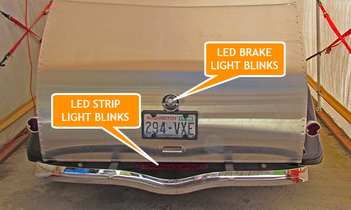

When I wired my teardrop I decided to add extra brake lights to the rear. I have an LED brake light/parking light in the center of the galley hatch and I have an LED brake light strip just above the bumper. To make wiring a little easier I connected these brake lights to the electric brake control of the truck.
Initially it looked like it worked but now that I just finishing up my teardrop and hooked it to the truck for the first time the two center brake lights blink every four seconds anytime the trailer is plugged into the truck. I believe the blinking is being caused by the Tekonsha P3 Brake Controller. It looks like, even when the truck is turned off, it samples the line every four seconds causing the lights to blink.
Tail lights.jpg (85.93 KiB) Viewed 5649 times
Does anyone have a solution to this so the lights don't blink? The trailer is really hard wired and difficult to change anything, I'd really prefer to use the Electric Brake Controller line if at all possible.

dancam wrote:Do you have a voltmeter that you can confirm whats going on? A low voltage constant feed (like 1.0v) can cause led's to blink. If its a pulse of 5 or 12v the brake controller may be faulty.
It's could be caused by a low voltage feed but could also be the sampling I believe it's doing. The break controller shows 0.0 on the display and it turns red and says "No Trailer Connected" then back to 0.0 and each cycle takes about four seconds.

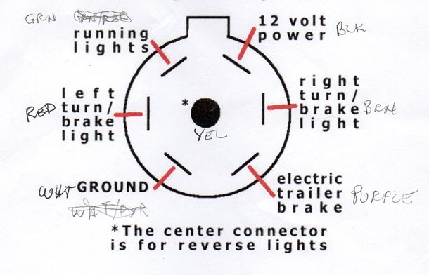

It's not the LED's feeding back to the controller it's the controller sending out a low voltage signal. If I put an incandescent bulb in the brake light it won't blink. The problem is the LED brake light strip that I can't make stop blinking.
Actually, using the electric brake control works kind of cool because as it adds power the lights get brighter.
Here's the pin-out on my Ford.
Trailer Plug001.jpg (43.18 KiB) Viewed 5510 times
