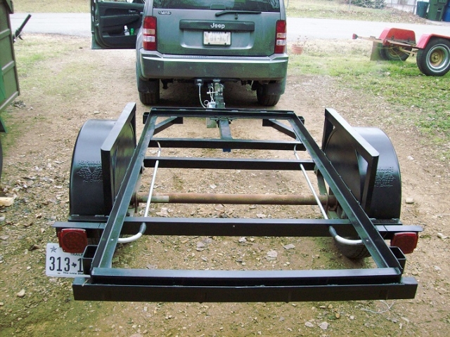

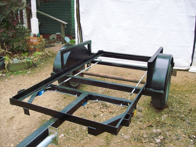

On my latest trailer, a 4 x 8 with a removable shell to transport my motorcycle, all the wiring for the tail, stop and clearance lights runs through 1/2" pvc electrical conduit or clear vinyl tubing The conduit runs through the drilled frame crossmembers and tongue.
All connections are inside plastic electrical boxes which are mounted on the backside of the bracket or frame member for the light fixture. The short length of wiring to the connector is encased in clear vinyl tubing sealed to the conduit with heat shrink tubing.

In my case there weren't many holes to drill and the floor had been removed so I could work from topside. My main concern was to protect the wiring from the axle, springs and shackles. There is a fused terminal block in the main box in the center and a universal ground wire to all the lights' mounting plates.
On my "Log Cabin" I ran all the wires through the clear vinyl tubing so only needed 3/8" holes. There is a large watertight box on the underside of the tongue just behind the hitch. I have a large terminal block fused for each separate circuit and couple of switches: One isolates the cabin battery from being charged by my tow vehicle. Another energizes the electric jack from either the tow vehicle or the cabin battery. There is also a quick disconnect for the 12V cooling fan for my generator when it is mounted on the tongue and running in the sound deadening box.
