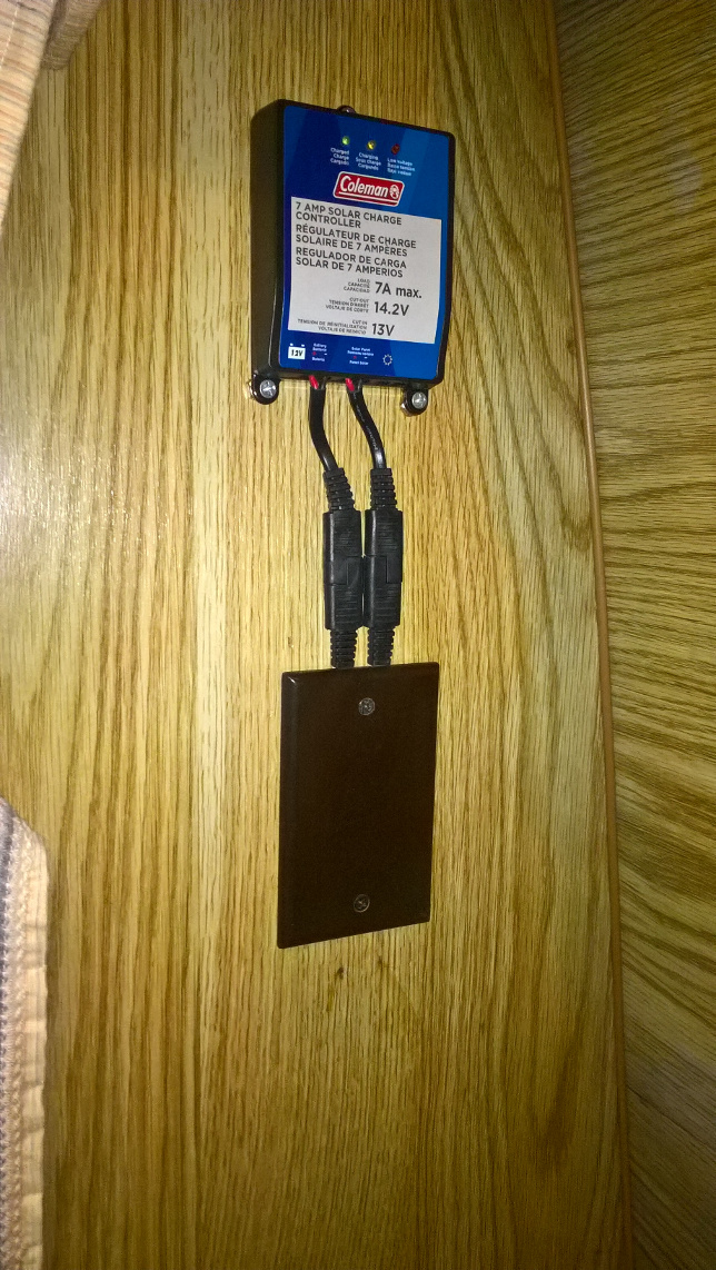

I've installed a roof-mounted solar setup with a Coleman PWM charge controller. I find that during the day my battery sits at 13.6-14.5 volts depending on sunshine, and stays that way all day. A couple hours after sundown it sits at 13 volts. At this point (No power from the panel) I tried turning on a few LED lights and ran the water pump for about 10 seconds. Then, with the lights still on, the battery read 12.8 volts. When I turn the lights off it goes back to 13 volts.
By morning the battery is 12.8-12.9 volts and then it goes back to 13.6-14.5 while the sun is up.
Is this bad for my battery? It's an 85Ah deep cycle, group 24.
I do plan to eventually swap out the controller for a proper MPPT one, but I was hoping to keep using this one for the rest of the summer.
Any suggestions/input would be appreciated

The battery stays full. When the PWM charges in constant current, bulk, mode it is turned on and the panel and battery are tied together. The battery voltage and panel voltage match. The 17.5 and 20 mean the controller thinks the battery is full and the panel to battery switch is off.
When the battery is almost full the controller turns the switch on and off rapidly to keep the battery at 14.4 volts or so. The voltmeter reading on the panel will be less than 20 and a digital meter might be erratic. An analog meter might be more useful.
A "proper MPPT" controller will do exactly what your PWM controller is doing, keep the battery full without over charging. It will also help keep your wallet from overfilling.
