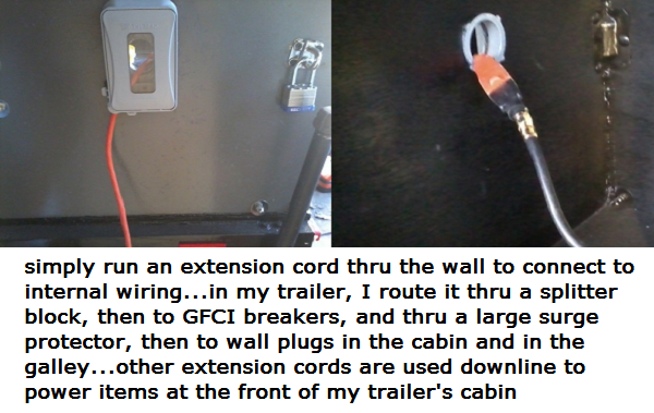

  • I use a single 120vac extension cord ( 16 gauge or 14 gauge, normally, but I have a 12 ga extension for long runs) because of my low power requirements (my A/C runs at <5 amps), run thru my galley wall. It keeps the cord end completely dry, even under monsoon conditions (Beaver's Bend '15), and can even seal when I used it for two cords at a time (one in, and one out). I bought mine for under $8 at Home Depot. If you plan to collapse your cabin into flat or semi-flat components, then the Taymac cover will work for you, since it's only about 1" thick, and doesn't have fixed wiring to deal with; once assembled at camp, you can just run the extension cord thru the cover, and split the power to your your items thru a GFCI splitter (also serves as a ground).
    taymac cover extension cord entry port.png (236.32 KiB) Viewed 1802 times
    the simplest method I know to keep my park power extension cord waterproof

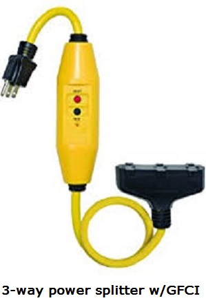

    GFCI extension, with a 3-way splitter.jpg (24.37 KiB) Viewed 1802 times
    for added safety, I use a GFCI device as a ground/breaker
