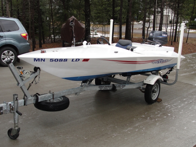

I like the isolator switch idea. I installed one of those on a ski boat I built with my son in 2008.
