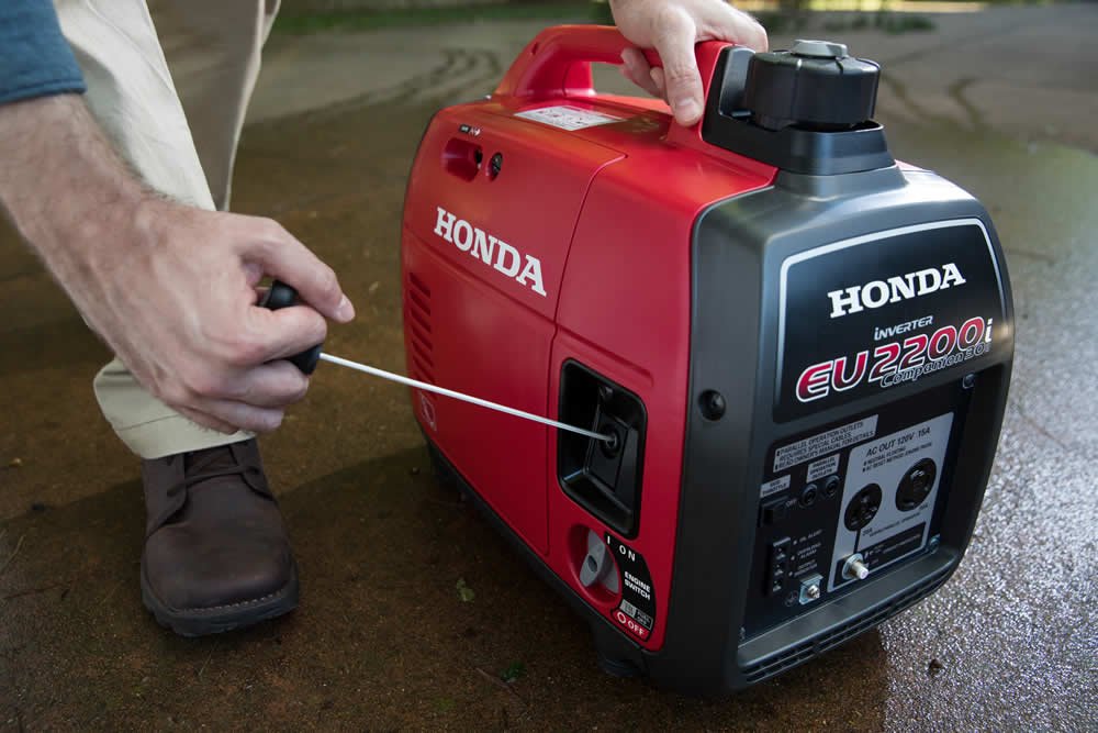

Postby John61CT » Sat Dec 22, 2018 7:08 pm
Yes, only a solar **panel** actually produces power for your loads.
Batteries only **store** that energy for later use.
Controller is needed in between to recharge the bank.
**This** is a generator
