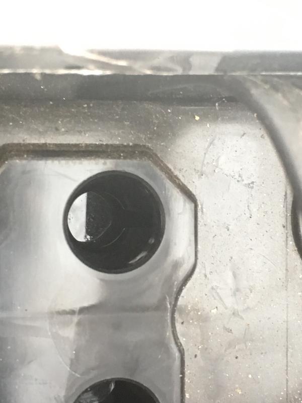

I was working on my trailer today and ran out of power to run a jigsaw from my 1000 watt inverter unexpectedly quickly. Here are some stats:
3, marine deep cycle batteries wired in parallel, approx 240 amp hours when new (2/15).
Starting battery voltage today: 13.8
Cloudy day, only 2 amp charging from solar.
Outdoor temp: 45°
After charging a tool battery and running Bluetooth speakers for an hour, the battery voltage was down to 12.4-12.5. With the inverter on, it dropped to 11.9 and the automatic shutoff engaged when I tried to run the saw. I have run this saw many times before via this inverter so I know the system is designed and wired correctly.
Is this just a problem because of cold weather? Or are my batteries getting old and tired?

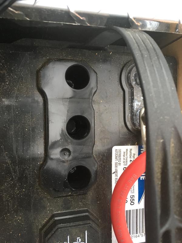

I have never before added distilled water to them so I wanted to check with someone who has. How does this look? At least I don’t see the plates so they appear to be submerged (a good thing).
Do they look low? If so, how much do I fill them with distilled water?

As long as each cell's plates are submerged, the battery should be ok, assuming nothing else is amiss.
If you have a decent vom, or dvom, you can check for a bad cell. Using your probes, start at a post, and measure from the post to the first cell, by dipping your probe into the electrolite, without touching the plates. Record the voltage, and move on to the next cell. Dip your probes into the electrolite, again without touching the plates, and record the voltage. Do that for the entire battery, and compare the readings from cell to cell. This will tell you if you have a bad cell, which draws the battery down prematurely.
You should get about 2.3 volts per cell. It can be low or high, depending on state of charge. More importantly, the readings should be consistent across the battery.
Almost forgot.....In your set of pics, second pic. Top cell is a bit low. Generally, those cells should be full to the bottom of that slotted tube. This allows for a bit of expansion, should the battery need it.
Oh, and NO SMOKING OR OTHER IGNITION SOURCES! Those lead acid batts give off hydrogen gas, and if one blows up, getting acid in your eyes is not something you will ever do again.

Do as above. For filling water get a dispenser like this. Fill it with distilled water, place the nozzle end in the cell, push down and hold against battery top. It stops dispensing water when the cell level is up to the proper point. Battery mfg have agreed on the plate to top distance.
