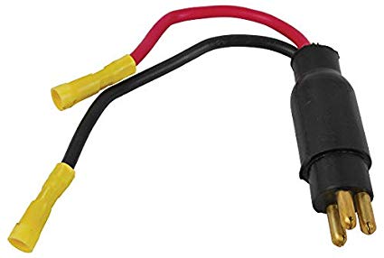

I used Atwood trolling motor battery connectors. They are marine rated which helps with corrosion and moisture. In my area they are also available at Napa, Ace and West marine. Ace was 20.00 for the set.
