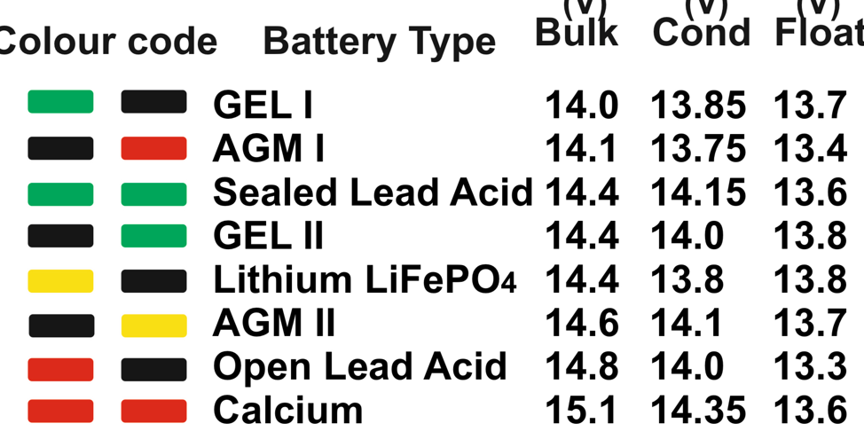

Postby featherliteCT1 » Thu Apr 11, 2019 7:08 pm
I looked at the manual for the Sterling unit and see that it has the following charge parameters that can be chosen:
Nice unit for $320.

Postby John61CT » Fri Apr 12, 2019 10:05 am
The ones prefixed with BB are the user-custom adjustable models.
John61CT
Posts: 1958
Re: Charging while towing - Dedicated 12V-12V Charger
Postby featherliteCT1 » Fri Apr 12, 2019 6:49 pm
John61CT wrote:The ones prefixed with BB are the user-custom adjustable models.
Thanks! I read the manual for one of the Sterling BB units and see, like you said, where the units are adjustable to almost any conceivable charge parameter using the remote device. Wow!
