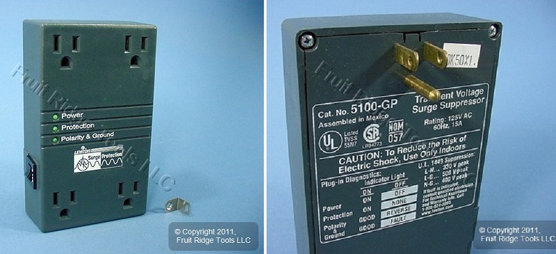

* I opted for plug & play. For under $15, I bought a four-outlet 115vac surge protector (Leviton 5100-GP) from a clearance sale at Fruit Ridge tools back in '14, and it has worked in my trailer since then. I was concerned about power spikes to my ac-powered devices, since I didn't use circuit breakers or fuses on that part of my grid (12vdc is protected by both, though). I rely on GFCI plugs/cords for wet safety (it always rains when I camp), but I'm not sure if a transient voltage spike would trip them or not, so I bought this as extra protection.
* I run an extension cord to a splitter block in my trailer (mounted up on the rear sidewall, protected behind a waterproof, in-use cover), then I have two GFCI plug-in adapters feeding everything from that point on: #1 thru the surge protector to the inside cabin, where the A/C, inverter, stereo, lighting, fan, and heater are, and #2 to power any galley needs/external lights/etc. that I may need. The system has worked so far, protecting my gear from spikes (one at camp last week), and all I have to do is reset the GFCI (the 5100-GP resets itself). I'm currently modifying my electrical outlets to include an external GFCI quad outlet (under yet another waterproof, in-use cover), so I don't have to open my hatch to use the new porch light, or plug in my electric skillet.\
* For more info on this surge protector (which seems to be discontinued), and how/why I use it, here's a link to an old thread about it & my trailer (as it was in 2014, and much the same today): http://www.tnttt.com/viewtopic.php?f=30&t=60587#p1088735
