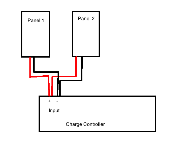

I have two solar panels of the same brand and same rating.
I plan on having them correctly wired in parallel but for testing purposes, would there be any ill effect if I connected the outputs (wires) of each panels, to the same terminals on the (PWM) controller?
Basically two wires instead of one, per terminals, respecting polarity of course.

Unless I am mistaken, my crude diagram shows a parallel setup. Except instead of connecting the wires from each panel into a "bus" and then connecting the "bus" to the charge controller, I connect both panels directly to the input terminals of the charge controller.

Postby MtnDon » Mon Apr 29, 2019 9:19 am
The panel Voc is higher than the max input rating of the controller. That is a problem under some conditions unless the controller has circuitry to limit the input. A cheap PWM controller probably does not have such a thing. . Voc
Electrically, the controller cannot tell any difference between the wires from the panels being routed through a buss connector of any kind and then ONE + and - wire connected to the controller, OR, TWO wires connected directly to each of the controller terminals. That does assume the terminal connectors can handle two wires at each terminal.
Note that IF you decided to have more than 2 panels in parallel you then need fuses where the panel wires are combined. If only two in parallel you are okay, assuming the panels are built to pass UL testing.
