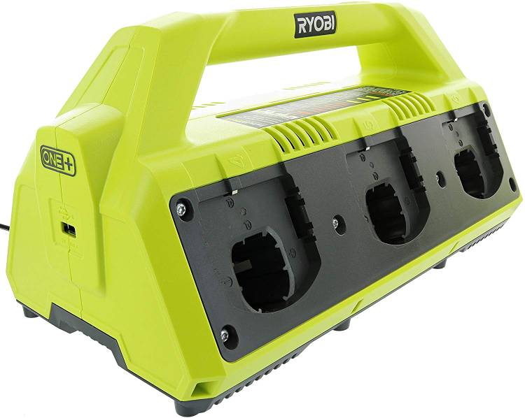

Connecting them can be "interesting". Either you build something they will click into like on a tool or you pull them apart to get the actual cells and wire them up in a new case. I considered the former. There were 3D print files downloadable for the Ryobi ones that could be changed from one to several receptors but in the end I kept it simple and got an AGM battery.

Yes, physical more of a DIY challenge than the electrickery.
Best to keep the modules intact, have internal BMS, the chargers tuned to the modules, including 12V input
