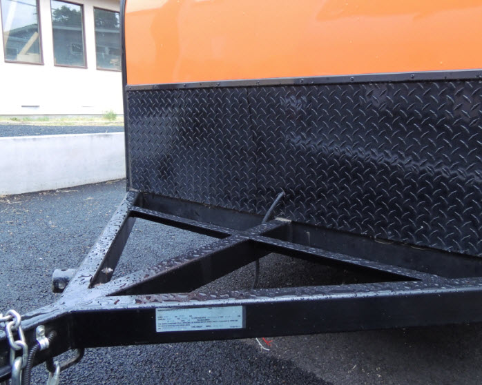

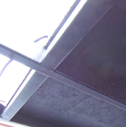

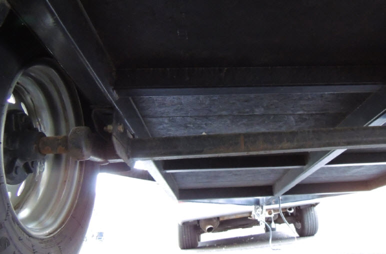

I have a battery on the tongue with the solar controller etc at the front of the interior of the trailer. The old wiring came through the wall, but I am using 10 gauge wire so the hole has to be a bit bigger.
Should I re-drill through the current hole, widening it, or should I drill down through the floor to get the wire from the solar controller to the battery? (see pictures)
Thanks!
The floor from the rear of the trailer
This is where a wire would come through the floor
Wires currently come through the middle of the wall

Running wires from the underside is much better as there's less exposure to the elements and not as noticeable when you apply your sealant.
I'd plug the old hole with maybe an automotive rubber plug and some sealant.

Definitely the floor. Rose is 11 years old, and underneath you can hardly tell she's ever been out of the garage.
