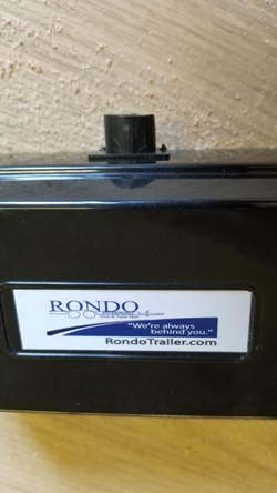

This is a test fit of the tubing in one junction box I am using, I will have one four prong plug elsewhere with easy access

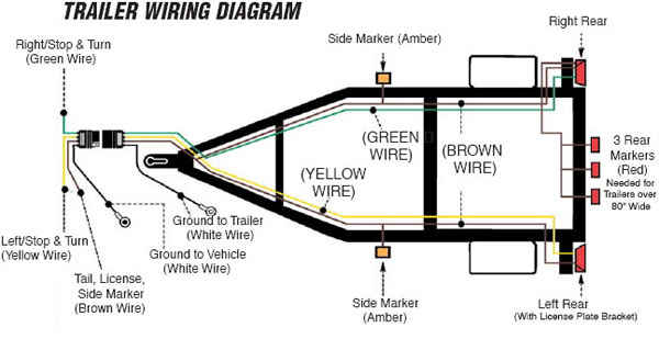

the attached diagram shows what you need(note the 80" and wider requirement of 3 lights in the middle on the back)
when measuring the width of your trailer you are basically measuring the TOTAL WIDTH of it's shadow at high noon in the middle of the summer(not just the width of the box)
if it is over 80" wide wire it for all the lights in this diagram
if it is under 80" wide you do not have to include the 3 lights centered on the back
it is not a bad idea to run a "ground" wire(labeled as WHITE in the diagram) directly to each light though it isn't always practiced even by commercial manufacturers
bolted together frames do not carry the grounding effect well thru the bolted elements and therein lies the prime source for trailer light failure/issues
totally welded frames work better("better" is a relative term here) when grounding to the frame
i have gone to using the self drilling/self tapping galvanized screws that metal buiding constructors use(removing the rubber washer) as a grounding screw on most of my trailers and it works quite well even for boat trailers that get dunked in salt water
if you are not running a battery charging system from the TV to the trailer or trailer brakes you will do just fine with the 4-prong flat plug
if you are charging a trailer/house battery from the TV while going down the road and/or you are running trailer brakes you will be well advised to use the 7-pin(flat pins) RV round plug (wiring instructions come in the package)
¿ clear as mud ?
