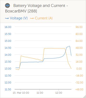

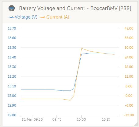

I have a Yamaha 1000w generator that's been having carburetor problems and wouldn't run anything without stalling. I finally took it in and had it fixed, so it was time to test my battery charger to see if the generator would run it. I have an Iota DSL-45 charger with the IQ4 LiFePO4 charge controller. 45amps X 13.8V=621 watts so my guess was that the generator would be right at it's capacity by the time you figure in losses and power factor. The Yamaha is rated at 900 watts continuous. I ran the battery down to 55% capacity, about 80 amp-hrs, to make sure the charger would be in bulk mode. I started the generator and plugged in the charger. The generator lugged a bit, then stabilized but the charger rolled back its output to around 30 amps rather than the 45 amps at full output. Then it continued to roll the output down till it was at 17 amps. Here's a graph showing the amps starting to roll off from 30A.
I unplugged from the generator and plugged it into utility power, and the same thing happened. WTF? I unplugged the charge controller and plugged it back in and boom, 46 amps. The charger maintained 46 amps till the battery was charged. You can see where I unplugged-plugged the controller as the current jumps up to 46 amps This is the entire charge cycle:
Interestingly, the voltage jumped up from 13.5 to around 13.8V with the current bump, which is in the recommenced range for LiFePO4 charging. I like how the charger changes mode at about 14V and tapers the current down to nothing until the battery is at 100% charged. Here's a close up of the charger finishing up:

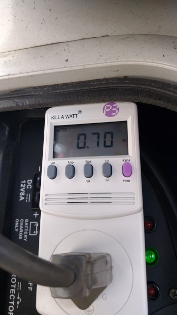

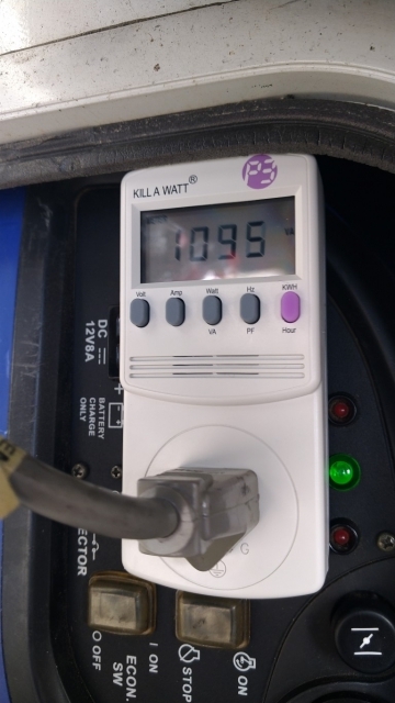

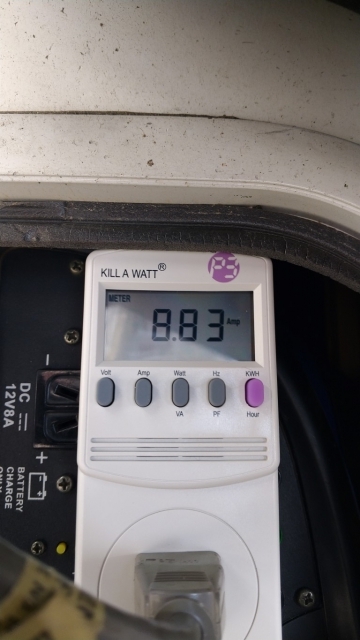

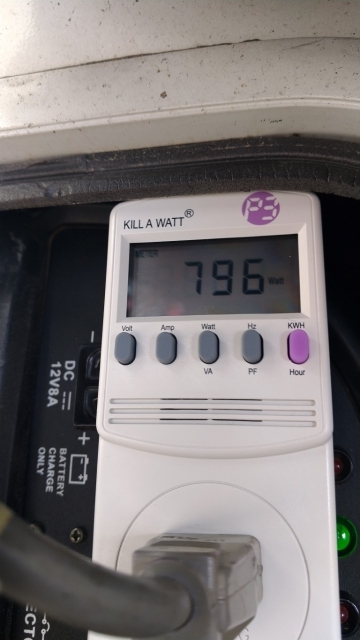

I used a Kill a Watt to measure some AC electrical parameters while the charger was full output:
Drawing 8.8 amps at 120V:
796 watts output the generator with 634 amps going into the battery. That's about 80% efficiency while charging at full output:
Power factor is awful, as low as 0.6 when the charger was at 20 amps, rising to 0.7 when loaded:
The real surprise was the Volt-Amp load; I wouldn't have guessed the generator would carry this since the power factor is so low. A 0.8 power factor is what most commercial generators are rated at:
