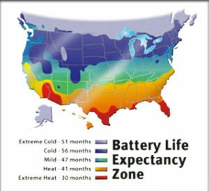

As for the original question, I believe that 5 years is a pretty good life expectancy from a good quality lead acid battery that is vehicle or trailer mounted and experiences some elevated temperatures. Here is NM I use best quality batteries and change them every 5 years because I do not like unexpected surprises, like not having enough "ooomph" to do whatever I was expecting. I have got 9 to 10 years out of flooded lead acid batteries in a stationary application and in a climate where the ambient temperature might hit 75 to 80 F for a few hours a day in summer, but fall back to the 50's overnight. Temperrure and vibratuon can shorten life just as over-discharging can.
By stationary use I mean like for an off grid cabin. In the mtns of NM the daily summer max temp is not too high in summer. The last set of batteries should have been replaced at the 9 year mark but we got an extra 6 months. A friend in the much hotter low altitude desert in AZ can only manage 2 years before a drop off in performance is noted.

Postby featherliteCT1 » Sat Jun 20, 2020 5:42 pm
MtnDon,
Wow! I knew heat was bad for batteries but had never seen the effect quantified. Thanks for the real life data.

The general rule of thumb we use is every 15F over 77F halves the battery life.

It has been stored in the shade under a roof mostly in the pacific northwest, so I have a generally low storage temperature going for me!
