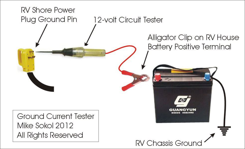

Postby featherliteCT1 » Fri Jul 03, 2020 3:41 pm
Mike Sokol says to bond AC ground wire to trailer frame. Same with ground wire for battery.
Here is a testing technique to test the adequacy of the AC ground connection.
https://www.rvtravel.com/diy-safe-way-t ... -rv-frame/
He says the above test "is far superior to just using an ohmmeter since it drives an ampere or so of current through the ground-bond connection
Elsewhere he also says no need to bond to an "earth" rod, for both a generator and an AC system for a trailer."
I wired my trailer in accordance with his advice. He does an excellent job of explaining the theory to support his advice.
