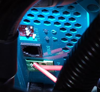

Having a bit of a time getting it to run.. I bought the 20a unit and ran the wiring yesterday from the battery and the 12v sensor to the tail lights for a 12v signal. No joy.. I do have 12V power in the line to the unit (tested).
Today I figured I'd run that sensor wire to the Battery + and ensure it has a signal of 12v power... No Joy... Power on that line, tested.
I'm setting up for Lithium so S1 off, S2, S3, S4 on and S5 off. That should be a 14.4v constant. From the manual, off is towards the printed numbers and on is away from. The manual is not shall we say, user friendly... It's a bit confusing.
I will call service tomorrow and work through this, yet if you know, please talk to me.. :?
What is the proper DIP positions for Lithium? Which way is really on? Suggestions on what I've missed in wiring this thing???

My DIP's are in the same positions as yours. That should be the 14.4 constant (best I can figure). Does your green light come on when it's running? I've yet to see a light, red or green.. I was wired to my running lights as well to engage the charger, then went direct to the battery to just prove it works.. Nada.. I think there's a issue with the unit.

Not sure how you are wiring the device. You state "the battery". I am assuming there are 2 batteries -- the towing vehicle(TV) and the trailer (TD).
The typical trailer light wiring is not designed to deliver a 20A current flow. This would include the running lights and the positive DC wire of a 7 pin connector.
Optimally you are running separate wire (8awg or 6 awg) from the TV battery thru a fuse/breaker thru an isolation switch to the rear of the tow vehicle. Plus running a separate ground wire of similar gauge. This wire and a ground would have its own (Anderson ?) connector. These two wire (with similar gauge) would be routed from the connector across the trailer to the DC-to-DC device as input. The 12V sensor wire would also be connected to this 12V positive wire.
Have you checked that the ground does connect back to the TV battery?
Have you attempted to confirm that Renogy device to a spare battery (as the DC source) to confirm it is no dead on arrival (DOA) -- light go on, etc I am not sure if this is kosher eg the charging battery and battery to be charger might have to present for confirming.

Let's see if I can clarify. Wired from truck battery +/- to the device input (thru a working fuse). Wire tested with Meter. Signal wire is back on the running lights (ignition), but did run the signal wire back to the battery positive (truck) as a test. Output is on my LiFePo battery run down to 13.16 as I run my refrigerator off it. I am metering only on the output side right now, so only if the voltage increases on the battery will I know if the unit is working. The green light is supposed to come on is running (doesn't) and red light if a fault (nope).
Difference for me is that I'm running to the truck camper, not a trailer. Same principles in play though..
