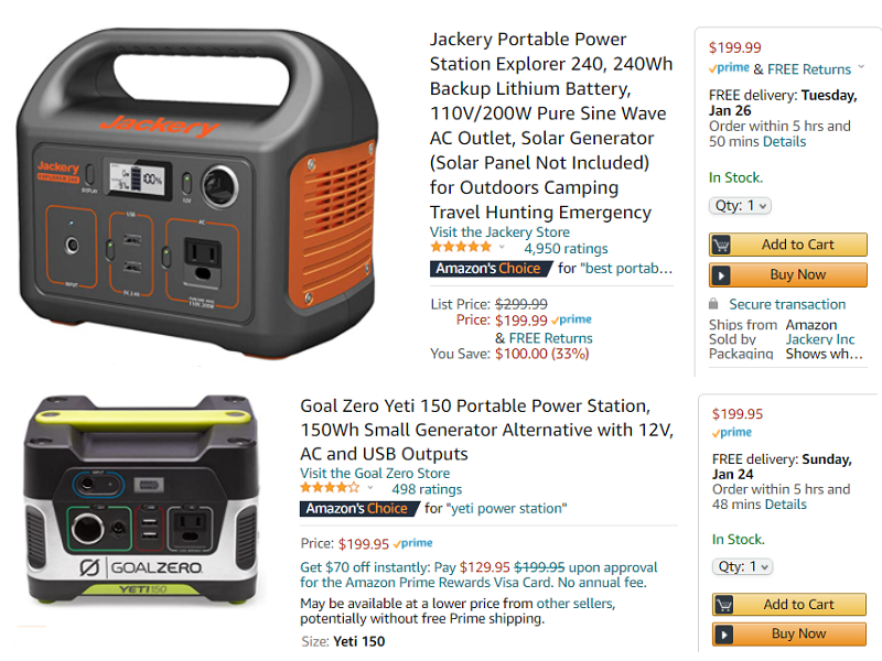

* I use an Optima Yellowtop AGM battery in the trailer, always maintained/charged while parked in the garage, but at 8 + years old, I'm considering replacing it with a Lithium Power Pack, for possible longer life, and definitely more versatility.
portable power.PNG (397.85 KiB) Viewed 1076 times
* I never camp long enough to warrant going solar, but that's a good option for the next owner of my trailer (at 70, I anticipate giving it to my grand-nephews, who are starting to camp and hunt). But, for short-term campouts, not near park-power, or needing to run the generator for the A/C, a power pack might be the best/easiest replacement for my AGM battery. It would probably suit your needs, too, at least getting started building/camping before you get all the details fine-tuned.
