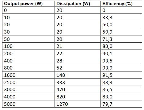

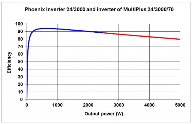

Postby bdosborn » Wed Feb 24, 2021 7:05 pm
The Victron 2000 watt is pretty efficient in its lower power ranges. The AC fridge draws around 150 watts, so I'll be in the 85% efficiency range:
That's right on the knee of the efficiency curve.
The 2000w should be a bit more efficient at that load than the 3000 but I couldn't find any data for the 2000. I can live with that loss, assuming the data they publish is issued by engineering and not the marketing department. :roll:
Victron Efficiency paper

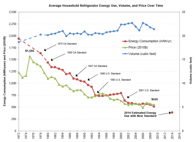

Postby bdosborn » Thu Feb 25, 2021 9:43 pm
Found a web site graph on refrigerator efficiency. Its a little old but still relevant. Apparently the energy star requirements ratcheted down 25% in 2014.
Refrigerator Improvements
I've got a DC amp-h meter on the fridge in the camper so I ran it for 24 hours yesterday; 19 amp-hrs. Not surprising when the garage is at 45F or so. I put the AC watt meter on the shore power to the camper, just to see if the meter is in the same ballpark as the DC meter. The Iota charger probably isn't as efficient as an inverter but it should give some indication of the losses to be expected. 10 years ago there would have been personal web sites that showed these kind of tests. Too bad Google killed the net.
