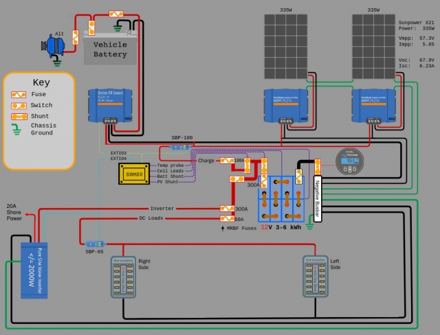

tony.latham wrote:Why two solar controllers?
Asking for a dumb friend.![]()
And, two Victron 75/15 are only $10 more than one 100/30.
lfhoward wrote:Being in Colorado, do you need to build in a way to heat the battery so it stays above 32°F when charging? I have read that charging LiFePO4 at below freezing temperatures causes permanent battery damage.
tony.latham wrote:Gotcha. I let my dumb friend know.
