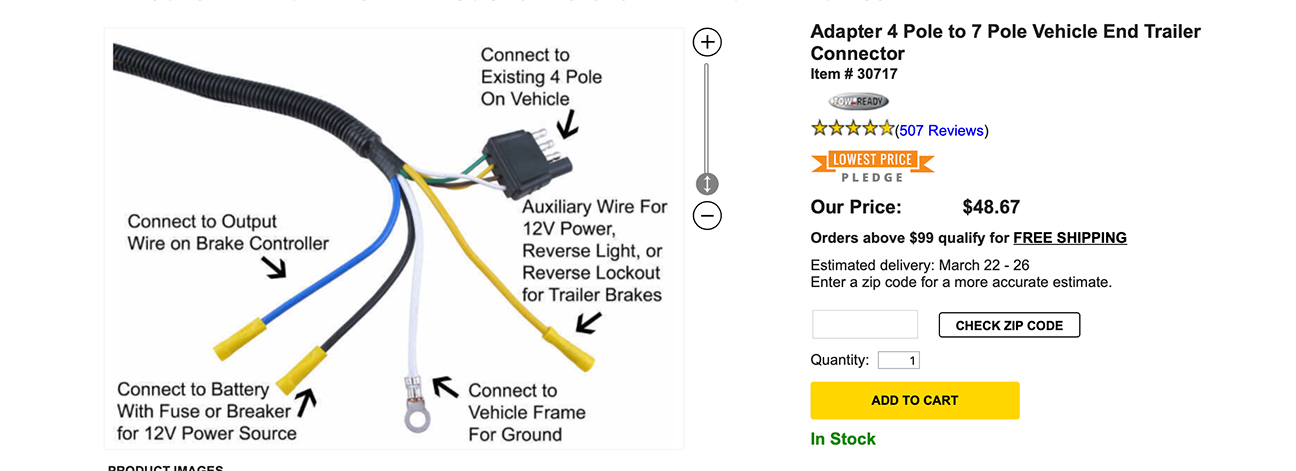

Thanks a lot for those tips, Socia Tom and Sparksalot. I looked up that product from the link you posted. Watched a video shown on the Etrailer site. Very helpful. They have this product shown in the attached photo. This makes sense and seems like what I'm looking for. Kind of makes it easy, I think. This 4 way to 7 way pin connector seems to take into account the brakes, the lights and the battery to battery charger. Need to study it a bit more, but I think this is the solution.
Thanks again.

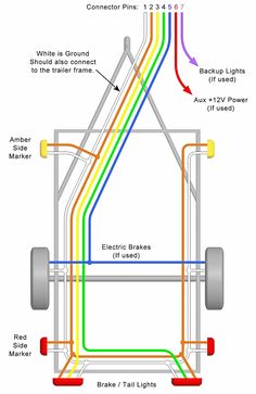

Capebuild wrote:Thanks a lot for those tips, Socia Tom and Sparksalot. I looked up that product from the link you posted. Watched a video shown on the Etrailer site. Very helpful. They have this product shown in the attached photo. This makes sense and seems like what I'm looking for. Kind of makes it easy, I think. This 4 way to 7 way pin connector seems to take into account the brakes, the lights and the battery to battery charger. Need to study it a bit more, but I think this is the solution.
Thanks again.
John
Capebuild, the image you are showing is the trailer side
the 4-prong flat plug has 3 unshielded male prongs which if they were on the TV could short out when the different lights were activated
here are a couple images that may help some
BON CHANCE
sw

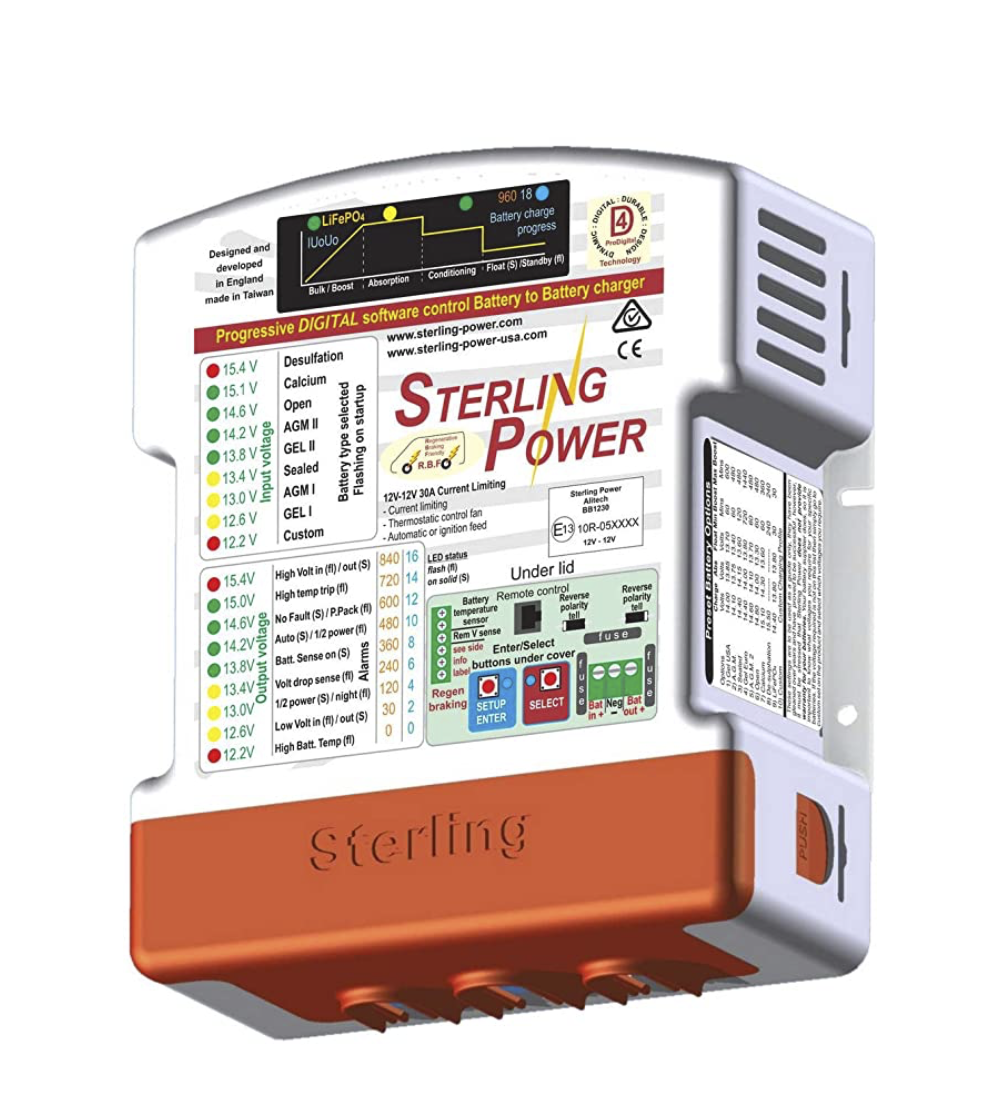

Postby John61CT » Thu Mar 18, 2021 1:46 pm
The charging of a deep cycling House battery in the trailer
from the alternator of the TV
is not so straightforward.
The amps current flow might be as high as 50-60A
requires a separate fat wiring pair and Anderson connectors
and likely a DCDC charger like Sterling BB series to counteract the voltage drop over distance.

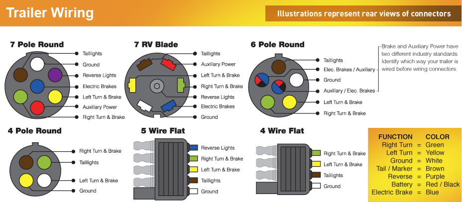

Thank you all again for the follow up and suggestions. I really need to wrap my head around all of this as it's all pretty much unfamiliar territory for me. But with these illustrations you've posted I can do my research and get a bit more knowledgeable with what I'll need. I have been looking at a set up another person had posted on youtube which really spelled out everything pretty clearly. It had a lot of components but it all seems to makes sense. He had a Sterling battery to battery unit in the mix (photo attached). His set up took Solar, batt to batt charging and shore power into account. I'm just pretty unfamiliar with the connections needed between tow vehicle and trailer... so will study up. I'll post the youtube schematic I had seen which I've been studying.
Thank you all again, I appreciate it.
Actually, one other question, Swoody, the diagram you posted, shows a red marker light at the rear of the trailer and an amber in the front. Is there a reason one is red, the other amber?
I just found that diagram on line, as well, from Johnson Trailer Parts with a good article on wiring. Thanks

The Sterling DC to DC charger says 30 amps. So, that 200 ampH battery shown could easily accept 30 amps. Given the long distance between the alternator and the trailer battery, I would use a plenty big wire determined by one of the AWG calculators online. My preference is to use the Renogy calculator on their web page. Once the AWG is determined, size the breaker 125% more than what is called for. Remember, we are protecting the wire not the devices.
I ran 3AWG equivalent copper wire from my 2018 Silverado truck battery back to my trailer battery (total distance for me is about 35 feet). I hate voltage drop and did not want to damage my alternator.
Also, make sure the vehicle's alternator can handle the load. Most alternators can be expected to provide continuously about 1/2 the maximum rated output power -- possibly as much as 2/3 for a conventional "heavy duty" design. Otherwise, the diodes in the alternator can overheat and burn out ... at least on my 145 ampH alternator.
Thanks again.
John
BON CHANCE
sw
No, he has the right thing. It plugs into the TV and adapts the 4 way to a 7 way.

Postby Socal Tom » Thu Mar 18, 2021 7:16 pm
Why do you guys have to make everything so complicated?
The adapter you found is perfect for converting the TV 4 way to a 7 way with trailer brakes. Just run a 30 amp circuit breaker with a 12 guage wire. If it pulls 50 amps something is wrong. I’ve been running a factory jeep harness for years with less than 12 guage, its fine, and it was designed at the factory and its behind a 200 amp alternator, its fine.
Don’t worry about fancy dc/dc charging unless your have lithium batteries or are a millionaire, or have a desire to waste money.
