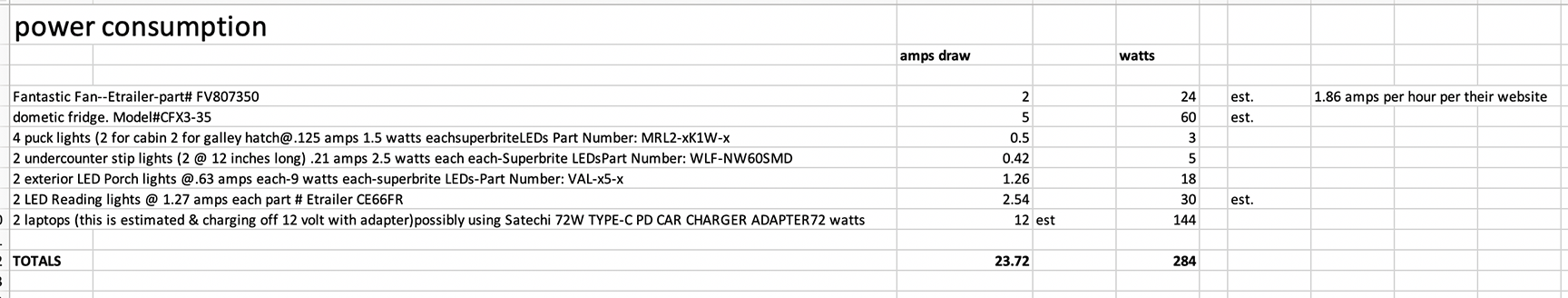

I put together an "estimated" list of devices I plan on installing, including their amperage draw and watts. (image attached). I've got a couple of questions:
1). I realize this amp total considers everything is powered on at the same time, which is worst case scenario..... but do these totals look like I'm interpreting all this correctly?
2). I'm planning on using 2/100 watt solar panels with MPPT charger (model not known yet, probably a Victron of some variety) and a Battleborn 100Ah lithium battery. Does the 200 watts solar look okay to charge the battery sufficiently to power these devices?
Any other thoughts would be a help. I'm not really sure how to interpret the 23 amps total draw... I'm just adding up the info provided on the retailer's/manufacturer's websites.
Thank you for the help.

Postby Tom&Shelly » Sun Mar 28, 2021 10:59 am
Capebuild wrote:I put together an "estimated" list of devices I plan on installing, including their amperage draw and watts. (image attached). I've got a couple of questions:
John
EDIT: I'm not relying 100% on the solar for power. Just wanted to get your thoughts on this setup. Also planning on batt to batt charging off TV battery with Sterling charger or other. Also will have shore power hookup with Genius 10 amp charger.
Hi John,
Off the top of my head, the numbers look reasonable. Assuming everything is on at once is a good worst case scenario. Of course, it may not happen or even be possible, and if necessary, you can play games with that.
So, how to interpret 23 amps (or other amps draw). Folks always seem to mis-state amps and amp-hours on this forum. Amps is the current draw when the appliance is on, and when you multiply by the voltage (12 volts in this case) you have, as you did correctly on your spread sheet, the wattage. That's power. It is essentially what you are consuming at an instant in time. When you multiply that by a time unit, such as hours, you have energy: Watt-hours. Note that is what the power company bills you for, for your home. (Usually expressed on the bill in kilo-watt-hours.)
If you divide watt-hours by the voltage, you have units of Amp-hours, which can also be thought of as energy (at an implied 12 volts). Of course, you don't need to go to watts. If you assume all of your appliances are on for one hour, you've drawn 23.7 amp-hours from your battery. Notice that's how deep cycle batteries are rated, in amp-hours.
So, if you have a usable 50 amp-hours (as I do with my 100 amp-hour AGM battery, which should only be drawn down half way) you would have a little over two hours of energy, with everything on at once. Sounds a bit grim, so now you may want to consider how long each appliance will be on, and add that to your spreadsheet.
I'm eyeing the 12 amps draw to recharge the laptops. How often do they need recharging and how long for them to charge? I doubt they'll draw that much once their batteries are charged. And so forth...
Hope that's helpful.

Postby saltydawg » Sun Mar 28, 2021 12:47 pm
I did this math before not sure if here or some where else, and it was an apple air book iirc.
The batteries in laptops are about 4400 milli amp hours at 12 volts are so ( 11.7 is nominal iirc ). Most laptops will run for about 5 or 6 hours on battery, so 4.4 amp divided by 6 ( best case ) hours is about .75 amps an hour. Figure most laptop chargers will charge the battery in an hour while being used, so figure 4.4 amps, plus the .75 amps. That get us to around 5.5 amps if being charged from a dead battery and being used but only the first hour.
So while 6 amps is a good number with a little room to spare, thats the absolute worse case load. Once charged the laptop should be using 1 amp or less per hour each.
