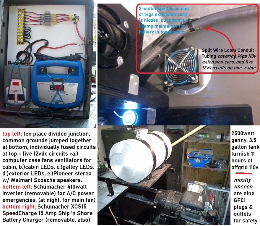

* I use both 110vac and 12vdc systems in my 4x8. I kept the systems as simple and separate as I could, only converging at one point: the converted key box I use for my 12vdc control switch, fuses, and inverter & on-board battery charger, inside the cabin, over my head on the back wall. At any time, I can get inside the box to swich 12v on-off, replace a blown fuse, connect the inverter inline to power inside the cabin 110v lights & accessories, and even hook-up the 15amp battery charger, to give the battery a larger boost (although it has a dedicated 1.5ammp maintainer in use). Both the inverter and 15amp charger can be removed to use on my to vehicle if needed.
* I used split-loom tubing to cover and obscure the single 14gauge extension cord I use inside the cabin for 110v, and the single multi-wire cable (18 gauge inside) carrying the five 12v circuits; it is meant for quick access and/or repair (my uninsulated trailer has no place to hide the wiring above the deck). Two heavy-amperage switches and fuses handle the 12v curret (4ga cable feeds from the battery in the tongue box, to the 125ampmaster cut-off inside the galley, then via 10ga to a 50amp on-off switch on the "key" box control panel. Never had a 12v problem in 9 years.

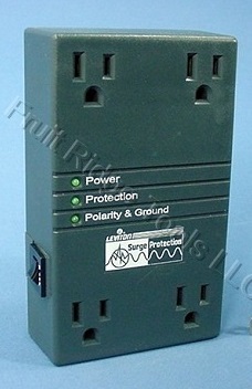

* For the simple 110vac supply, I use a 12ga extension cord (from the park-power pole) to pass-thru a waterproof cover into the galley, where it plugs into a GFCI. Then, it feeds into a resettable surge protector, then into the cabin-feed-point receptacle (which can also be supplied by the on-board 2500watt generator, offgrid). Once again thru a GFCI with a three-way splitter, to supply my 5k btu air-conditioner, main air circulating fan, and two sets of a/c powered LED lights (there's also two sets of 12v LED lights, permanently powered-up). There's also several more GFCI outlets, inside and outside, that protect my external lighting and cooking circuits. It always rains when I go camping. Better safe than sorry!

surge protector used in lieu of a circuit breaker for my 110vac power supply
