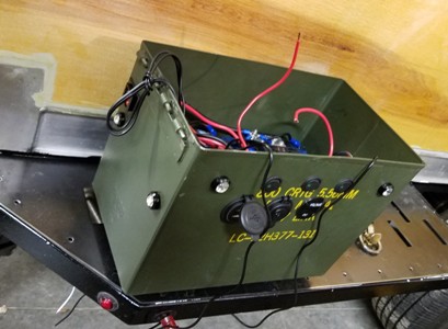

Postby twisted lines » Sat Apr 24, 2021 2:26 pm
Here is one of mine & where it will stay :?
30 A ish.jpg (42.66 KiB) Viewed 1138 times

Re: running internal lights off of a USB phone battery pack?
Postby Sparksalot » Sat Apr 24, 2021 5:59 pm
flboy wrote:You could make one of these and charge it from your tow vehicle's Cigarette lighter. Could run LED lighting, a small fan, charge a phone.. etc.. Can also charge with a small solar panel... some call these "Solar Generators".. which doesn't make sense.. Just a portable AC/DC power pack with decent capacity. I literally just built this earlier this week. A DIY option to the Yeti or Jackery.
https://www.youtube.com/watch?v=hpAXnsKPgVM
That was cool. I was curious why you didn’t add powerpoles too?
