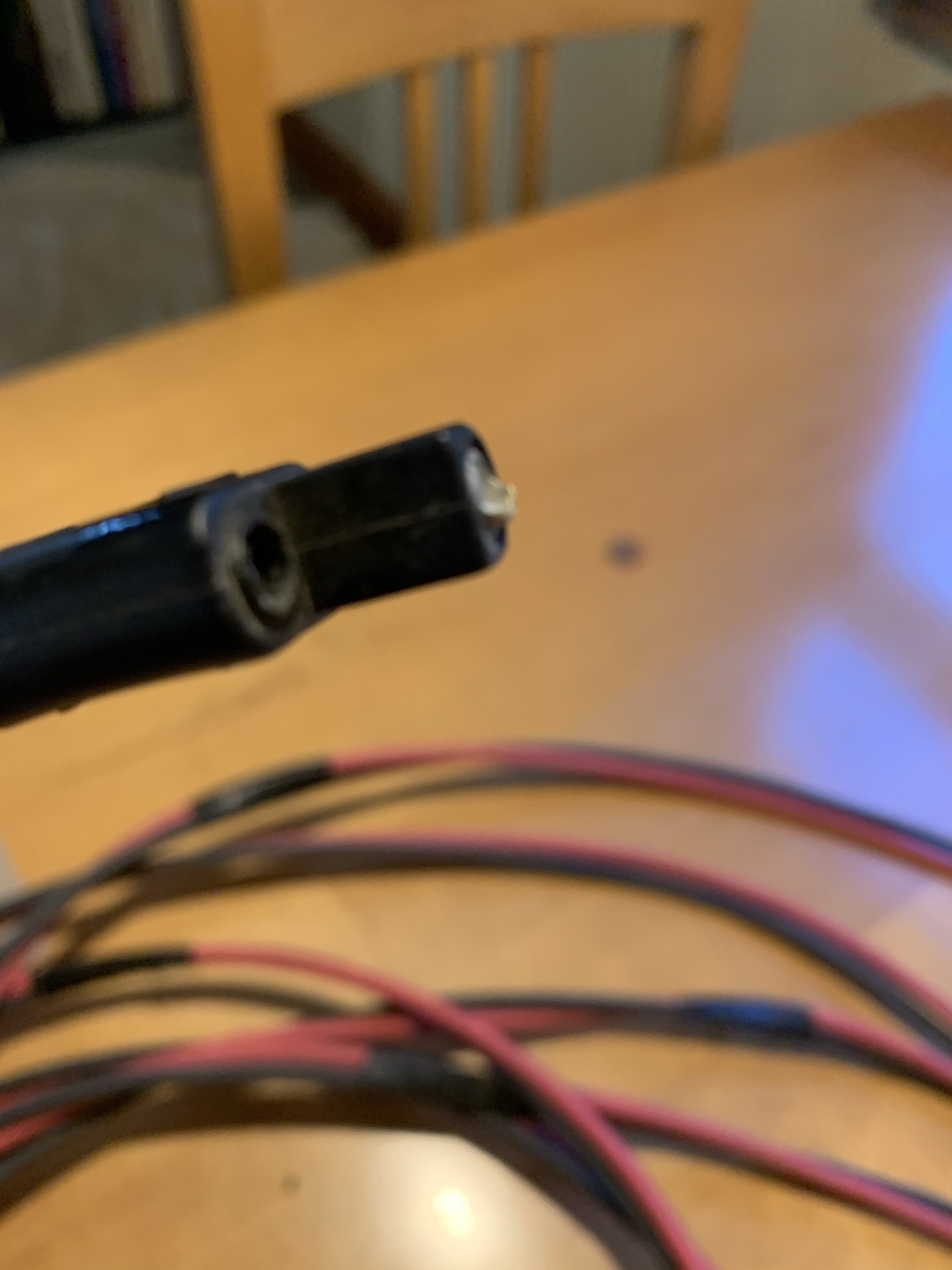

Thanks guys, I really appreciate the responses. It is not hooked to solar when this happens. I will take a look at those power meters. The solar connection to the teardrop is SAE, and I need to replace the cable end (see pic) as for the second time it has busted on me. That’s a whole ‘nuther subject :(
Thanks again!
