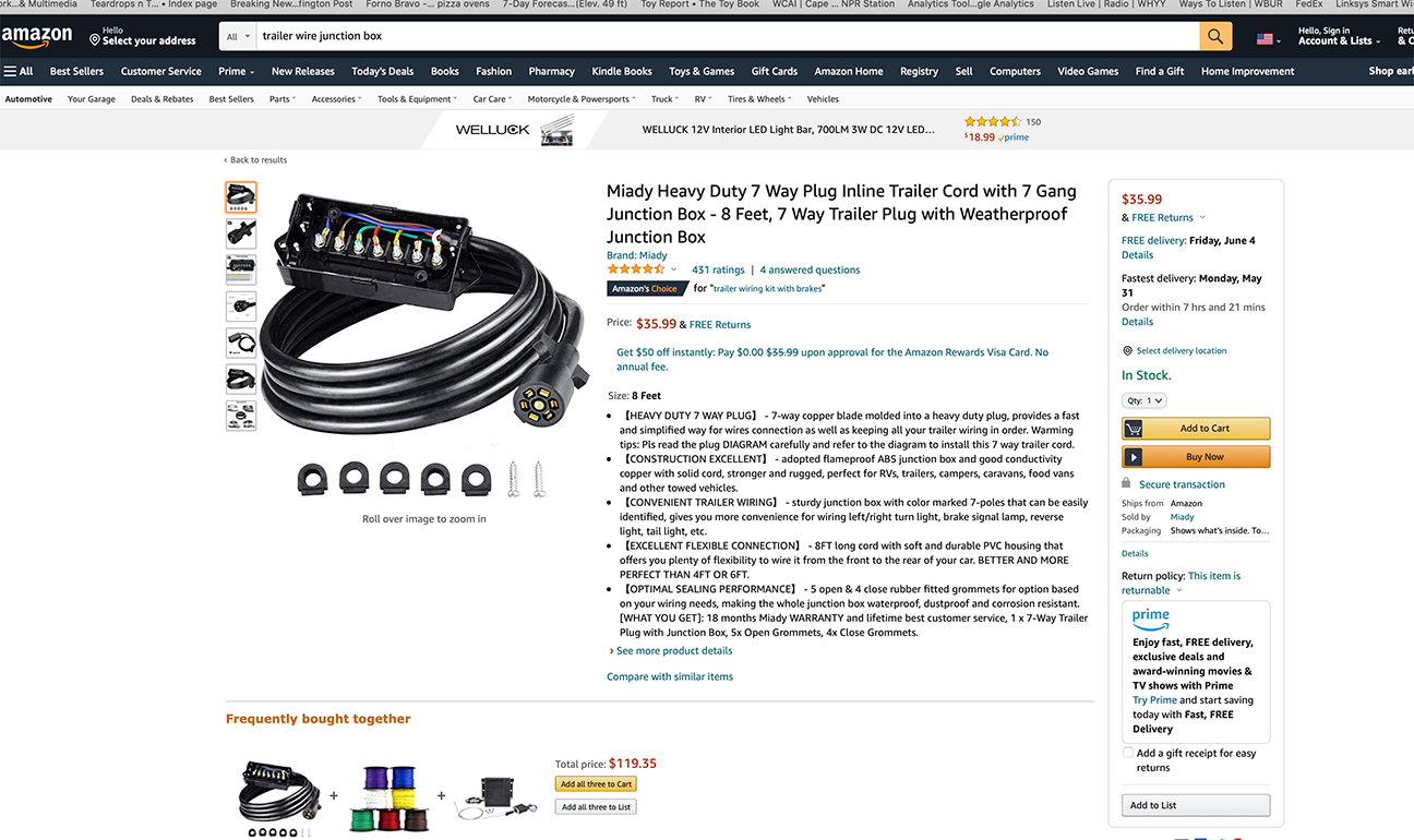

Hello... I'm looking to purchase a 7 pin wire Junction box to make all my connections from TV to teardrop. I don't have any experience with this sort of thing and wondering if this looks like what I should be considering.
If there are other suggestions, other brands.....I'd be open to hear them.
Thanks!
John

John, that looks like a very "professional" way to finish off the wiring harness. Had I seen this when I built my woodie it certainly would have made more sense and probably not cost much more after buying the 7 way trailer end pigtail and making my own junction box. I used a $9 waterproof PVC box from HD. Not elegant but serves the purpose. I probably spent nearly the amount for that kit you posted.

John, looks like the one I use.
I make a label on the cover to remind me what wire terminals are for what.

Basically what we have. Ours was made by "MICTUNING"; I have no idea if there's any difference. No complaints after two trips.
I think I overdid the number of separate wires terminated on a few of the studs. (5 or 6 on the ground and on at least one other stud.) If I were to do it over, I'd lead one wire out to a separate terminal strip (our J box is in a waterproof utility compartment) and run the multiple wires to separate studs on the syrip. I replaced their nuts in the J box with the proper metric sized nylock, and they seem to have stayed tight over about 20 hours of driving so far.

I too use the Mictuning. It's got the double female brass connectors.
But the one you've got pictured uses the same photo on Amazon. Must be rebranded.
https://www.amazon.com/gp/product/B01M1FC3WG/ref=ppx_yo_dt_b_search_asin_title?ie=UTF8&psc=1
Keep in mind there are two color systems used. The 7-way traditional (for utility trailers etc) and the 7-way RV Standard (for 5th wheels). Now, why there are two systems is beyond my comprehension. The Mictuning uses the RV.
