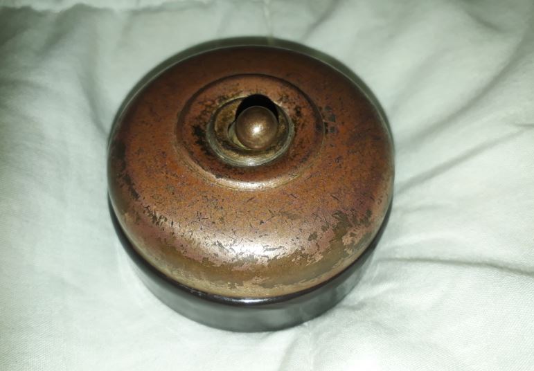

I got three new old stock light switches. Ceramic bases, built in fuse wire, brass covers.
They have quite a bit of patina, but when you open them up, they obviously have never seen a screwdriver.
Normally, I advocate against using mains switchgear on 12v systems. Switching AC is different to switching DC and you can get dangerous arcing using the wrong switch.
But these things use double knife type contactors to break the circuit, and the gap in the off position is huge.
I reckon they will be the light switches in my next project. It'll use LED bulbs so won't be switching big currents. I can't imagine them arcing.
They are single pole single throw, though.
I sat down with pencil and paper and tried to imagine a circuit where I could use these to switch on and off from either door.
Two switches to operate one light circuit.
This is normally accomplished with single pole double throw switches, but I wondered whether I could utilise diodes to come up with something. Alas I couldn't imagine a circuit that would work. Still they are cool and will look great polished up.

If you dont mind getting a little more complicated they do make 12v mechanically held lighting contactors that are pulse on or pulse off. That means you just flip the switch on then off and the light would be on, then another flip on and off and they turn off. would not matter which switch you did it from. Something like below, but 12vdc will be harder to find, and they wont be very cheap.
There is also ways to do it with relays, but they add parasitic draw.
https://www.eaton.com/us/en-us/catalog/ ... ctors.html
