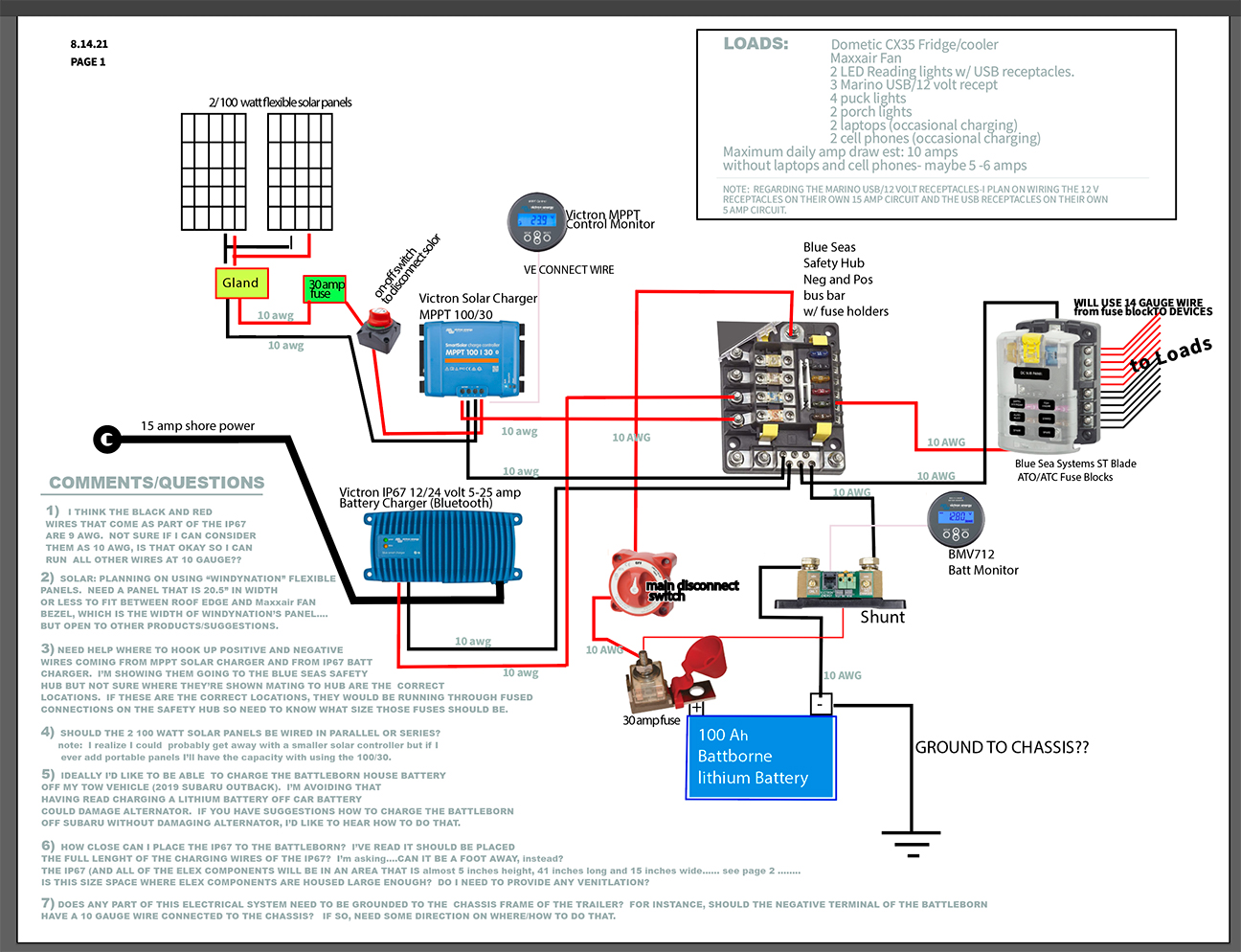

Should I be running a wire from the negative terminal of my lithium house battery to the steel chassis frame to act as a ground?
If so...... I'm using a shunt connected to Victron battery monitor. Does this need to be considered if running a ground wire from battery.....
I guess what I'm asking ... should the ground wire to frame be connected to shunt or to battery neg terminal?
Thanks
John

The shunt needs to be connected to battery neg terminal then from shunt to either chassis or busbar. so all loads and charging runs through it.

John, if you are using the frame as a return on your 12 volt battery system, the shunt should go before the frame ground, as was state above (by Benno). The shunt is measuring the electrons going into and out of the battery to keep track of its charge, and so it needs to "see" everything including any lights, etc. using the frame as a return. (Hope that makes sense.)

I was just asking about the house battery system (cabin lights, fridge, fan, etc). I've posted a picture of what my elex set up will look like.... so you can see what I'm referring to in my original question. Wondering whether I need a ground as shown in the image??
Thanks!

The official electrician in me says to run a ground wire to the frame, but dont use the frame as a conductor. The reason for the frame being grounded, is in case anything ever shorts to ground it will blow the fuse. Figure the only thing that the wire can really short to is the frame, wood wont short. Since your not using the frame as a conductor, just a safety thing connect it to the neg any where, as it should never carry power anyway the shunt wont care. But its not like 12 volts is very dangerous.
Same reason with a 110 volt system you should run the 110 ground to the frame, better to have it short and trip than to energize the frame. Now this does not matter much on teardrops with very very basic 110 volt systems, this is more of an rv thing.
