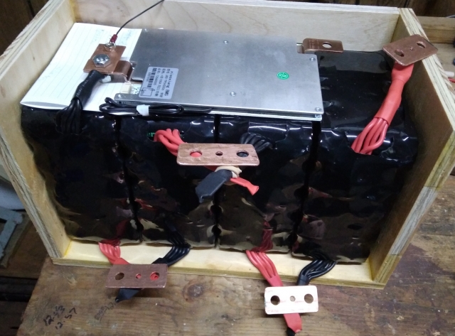

I recently built and installed a 156 amp hour LiFePO4 battery in my trailer. That how-to thread is here:
https://www.tnttt.com/viewtopic.php?f=30&t=74022
Here is another good LiFePO4 battery thread by TimC:
https://www.tnttt.com/viewtopic.php?f=30&t=74074
Photo credit: TimC

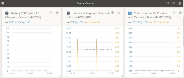

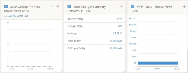

Postby bdosborn » Tue Jan 04, 2022 10:23 am
lfhoward wrote:If anyone is already running the VRM (Bruce, cough, cough…) if you could post some screen grabs of it actually running so we can see what kind of data you can monitor, that would be awesome.
Here's what I watch, the trailer is in the garage so nothing interesting is showing.

Postby lfhoward » Tue Jan 04, 2022 11:45 am
Bruce, that’s awesome! THANK YOU. :thumbsup:
Looks pretty comprehensive. I haven’t got mine installed in the trailer yet so am still looking forward to monitoring my system remotely. Everything is functioning on my workbench though.
