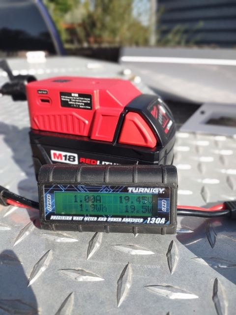

That's a great use for a tool battery. I made a similar rig to power a Starlink Mini dish using Milwaukee batteries I already had.

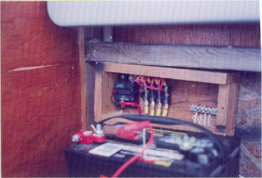

Postby bobhenry » Sat Feb 01, 2025 8:14 am
gallery/image.php?album_id=1521&image_id=37621
Used battery wired to dc breaker then fed to an automotive style fuse box and fed to the dc components all the grounds return to the grounding lug bar and finally to the battery. Don't you just love my UL approved electrical enclosure :roll:
