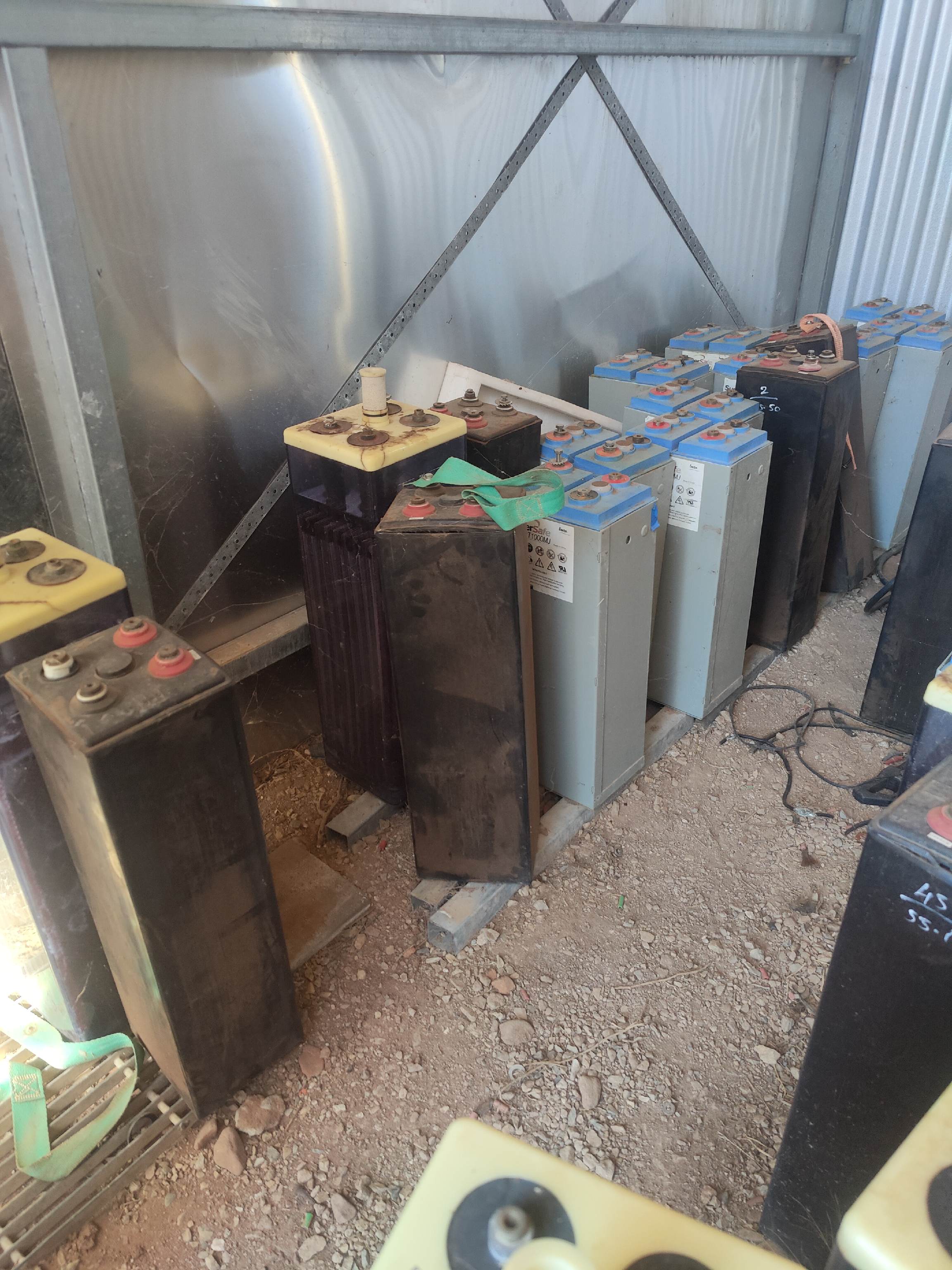

My son has been asked to test some big 2v cells. I have one photo to go on. (Below)
There's one in the foreground with a split case (the one with the green strap on it). I'd probably call that one unserviceable.
Some are flooded lead acid with clear cases. These you should be able to visually inspect and verify the sediment in the bottom has not built up enough to short the plates, check the plates aren't warped and touching, charge them and test the electrolyte for specific gravity.
Not sure of the others, if they are flooded lead acid, could charge and test the electrolyte S.G.
How to test them if they are AGM?
I'm assuming the blue top ones are 2V, but they have two breather/filler caps, so maybe they are 4V.
What is an acceptable load to test whether they can deliver? Eg, is it C20? i.e. a 1000AH cell should deliver maybe 50 amps?
Any gurus who can propose a relatively scientific charge and test protocol?
Does anyone recognise tem?
Frankly, they look too neglected to me.

More info - this was a guerilla standalone solar system a woman's crackhead husband built to power their new rural house. Dodgy as f@(k is how my son described it.
Somehow the Office of the Technical Regulator got wind of it and sent two guys in Hazmat suits and PPE to dismantle it before they blew themselves up.
I believe anything that could cause a safety problem was present. I can see quite a few things just in that one photo. Turns out if it is mains voltage, the technical regulator has jurisdiction even if it isn't grid connected.
My son set the lady up with a temporary generator feed that isn't very big, now the lady is trying to get some bucks together to run a grid connection, and has hopes of selling anything that still works. I told him we should find out what would need to be done to test them, tell her what she needs to do, and then stay right away from it. To actually do the testing would probably take days with no guaranteed outcomes.
"Don't touch that stuff son, it's got redback spiders all over it." :shock:

Postby John61CT » Tue Apr 05, 2022 11:36 am
20-hour CC cap test (0.05C) between
100% Full as per trailing amps spec
and 10.5V, immediately recharging after.
If SoH% less than 70% rated, recycle out.

Postby bdosborn » Tue Apr 05, 2022 12:17 pm
First step; get a voltmeter and test the voltage on each cell. It's dead and gone If its been sitting at zero. Those are huge cells, I've only seen batteries that size on megawatt range UPS systems at phone company central offices.

Postby MickinOz » Tue Apr 05, 2022 4:33 pm
bdosborn wrote:First step; get a voltmeter and test the voltage on each cell. It's dead and gone If its been sitting at zero. Those are huge cells, I've only seen batteries that size on megawatt range UPS systems at phone company central offices.
I've only seen cells this big on large capacity stand alone solar systems on sheep stations, etc.
Its easy to test cell voltage, and I've already told him if it has been stored flat, its cactus.
John61CT wrote:20-hour CC cap test (0.05C) between
Yes, a capacity test is required, that much I already knew.
One challenge will be finding the specs.
What I want to know is how to do the capacity test?
Suggestions what to use for a load, etc?
Going by the partial model number I can see, they might be 1000AH cells. So C20 is 50 amps?
Now V= IR last time I looked.
so a 2,1V lead acid cell delivering 50 amps would need a 0.042 resistor capable of dealing with 105 watts?
Is that literally all you do?
Charge the cell, then see if it takes 20 hours to get down to 10.5 volts?
I think this is going to be labour intensive and the woman is probably better off selling them for scrap if she cannot do all the testing herself.

I was just reading about some 'different' battery types the other day. Some very old designs are still in use in different pars of the world. The one with the yellow top and the tall thing in the middle looks like the diagram I saw of the Edison nickel-iron battery. The brain trust over at wikipedia declared that this technology is fairly stable and still used for off-grid systems. It takes a charge very slowly. Said to have a usable shelf life of 30-50 years. Not sure about some of those others.
