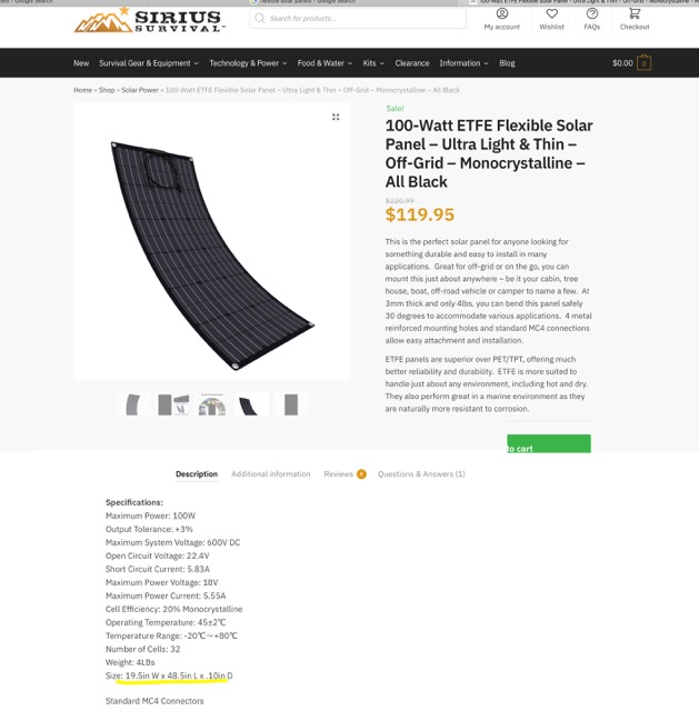

The "semiflex" panels last a small fraction lifespan compared to framed rigid.
Yes giving cooler airflow underneath is great, almost mandatory.
The substrate must be 100% rigid, a curve is OK but for longevity, the panel must not be allowed to actually flex once installed
Including due to highway speed winds...

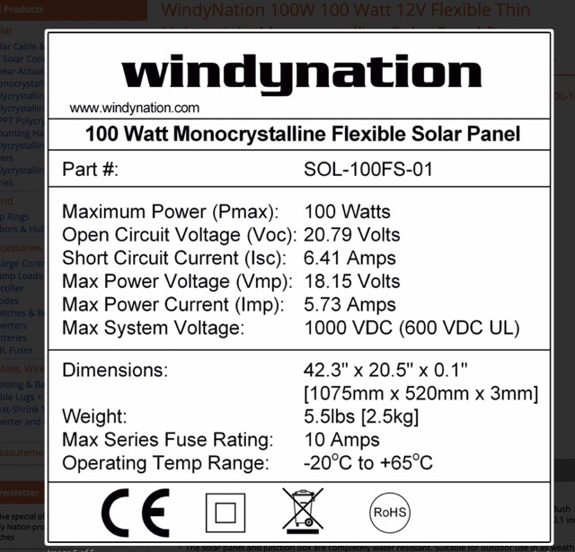

Postby Capebuild » Sun May 01, 2022 6:55 am
Thanks John and TCJ for your thoughts. John, yes... after I had posted my inquiry I realized the elevated "flex" panels lifespan would probably suffer.
I had gotten the idea from looking at the Lightleaf set up... but I realize their backing, being carbon fiber, prevents the damage that would most likely occur elevating a flex panel. Their panels sure are nice. They all curve along the opposite axis for what I'd need.... plus they seem to be quite expensive, about $470 a panel. But if they truly lasted 25 years, they'd probably be worth it.
I did find these two brands (see attached) both having a flexible 100 watt panel that would fit my available space. Anyone know anything about or have any opinions about these panels or about Windy Nation's panels? (if you click on the image it will enlarge and more tech data will appear)
Thanks
