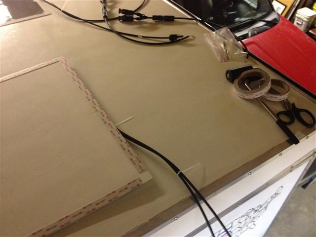

Postby cjlangellier » Sat Jun 04, 2022 6:07 pm
I ran tape horizontally on the top bottom and middle of the panel. I left the ends open to drain water. When I was researching the tape method, I remember seeing that you don’t need to use full strips of vhb down the panel, you can get away with 4” on 4” off tape pattern, but I ran a solid strips from end to end. I was nervous about trusting the tape to hold the panel down. I think that was probably overkill now that I have a little more experience with the tape. They use this same stuff to bond the aluminum panels together in rivet-less cargo trailers.

Postby TCJ » Sun Jun 05, 2022 10:51 pm
John,
I was just at the Roadtoad/Camp-Inn factory and they showed me how they do it. They use VHB tape, but are careful to leave some gaps so water can drain if it gets under the panel. Obviously those gaps are on the low side of the panel, but also some along the sides.

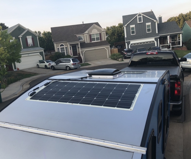

Boxcar flexible panel install

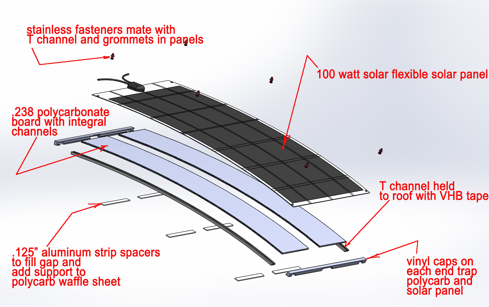

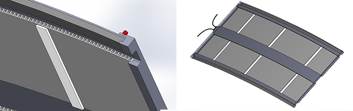

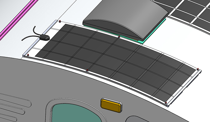

Postby Capebuild » Tue Jun 07, 2022 7:43 am
Thanks for all the feedback. After pondering all this a bit, here's what I came up with how to install the panels.
First off I had found this video on YouTube by Brian of RVwithTito. I liked his system he came up with and I made a few adjustments using his method as a starting point. Here's a link to his video. https://youtu.be/uJIEXhnF8MU. I really liked using this polycarbonate material with the channels molded into it. I think it will support and elevate the panels off the roof of the trailer and provide some nice air flow with those channels. I wanted to avoid any sag that might develop over time, so I added some spacers between the bottom of the polycarbonate and the roof of the trailer. I also expanded the air/water flow channels a bit.
Below are some images of what I designed. I also liked the use of the T channel molding which provides for the panels to be elevated and a way to insert bolts to pass through the grommets on the panels to hold them down. I suppose there's a fine line between having the openings to provide air flow and a way for water to drain out but not have them too large so to avoid any air lift while driving that might want to try and lift the panels skyward.
Any comments are welcome.
Thanks
John
EDIT: One thing I meant to mention.... I don't know how long these panels will last (hopefully at least 3 years).... but with this method of install I think they will be fairly easy to swap out with new panels when the time comes for any replacement.
