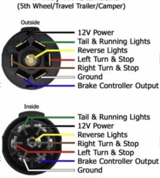

does your TV have the factory installed towing package ?
if so all you need to do is run a wire from the plug to your battery
the factory systems isolate the RV battery from the TV system when the key is off so the TV's battery doesn't discharge
here is a diagram of what came w/ both my F-350 and my Jeep Cherokee factory towing packages
the "12v Power" is the one

swoody126 wrote:does your TV have the factory installed towing package ?
BON CHANCE
sw
That will not work for charging lithium batteries
BON CHANCE
sw
Cheers
Paul :thumbsup:
Do you have any idea how i can do it without spending too much money.

Postby swoody126 » Thu Jun 30, 2022 1:55 pm
The attachment VmDJZkF.jpeg is no longer available
BON CHANCE
sw
Cheers
Paul :thumbsup:
sw

You would really have to add wiring (10 gauge or smaller (bigger diameter) depending on distance), solenoid, fuses, Anderson connectors, more wiring, glands from the vehicle battery to the trailer to make everything work. Think high power car audio system (do people still do that?) The 12V power wire on a 7 pin connector is not rated to carry high current (40-60 amps) -- more like minor charging like an electric brake battery charger.
