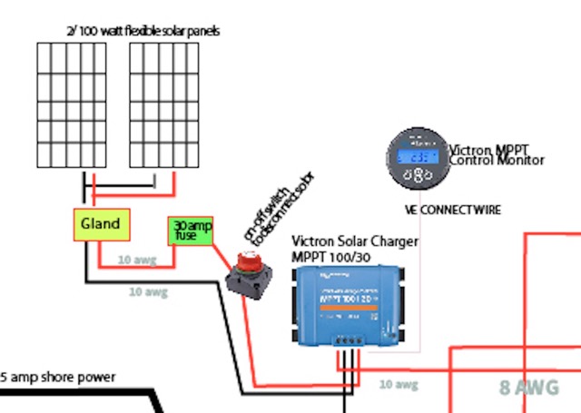

Postby Capebuild » Wed Aug 17, 2022 5:50 am
Attached is a snap shot of what I did.... adding a 30 amp fuse before the charger.
John

Thank you lfhoward and Capebuild for your replies and comments. The video that lfhoward linked was very informative. He seems to know what he's talking about. Initially I will have one 100 watt solar panel, and in the future possibly two wired in parallel. I purchased a Y connector from Renogy to tie the two solar panel feeds together. My plan now is to install a 10 amp fuse in the 10 AWG wire which runs from the solar panel to the Y connector. When and if I install a second panel, I would do the same on that wire. That will limit the current in each of those wires to 10 amps, which should limit the total current flowing to the controller to 20 amps. Capebuild, I like the switch you put in. I also would like a switch to shut off the power from the solar system so I can work downstream without having the system charged. As far as location of the switch, I am thinking of putting that switch between the controller and the main fuse block so that when I shut the solar system down in the garage I'm not getting any parasitic loads from the controller. I will also put a 20 amp fuse between the controller and the main fuse block. That's where I'm at so far anyway!
