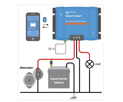

You picked the beefy Orion with a 70A output and a surge of 85A. 85A/2=42.5A at 24V So I would use a 45A fuse on the 24V side of the Orion, and #8 wire. I would use a #4 wire on the 12V side to your fuse distribution.
Here's a wiring diagram of how the Orion is connected:

Thanks bdosborn. So it’s ok to hook all grounds back to the 24 volt battery? It the pic it looks like all the grounds eventually are connected. If that’s the case, I’ll use a distribution block.

Postby bdosborn » Thu Oct 27, 2022 7:36 am
Yup, all the grounds go back to the 24V battery. :thumbsup:
