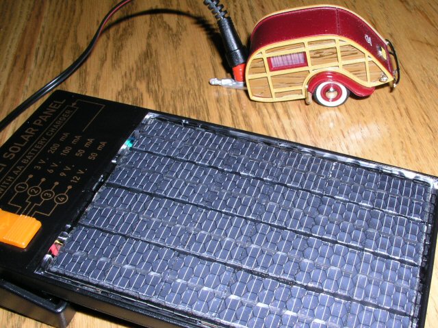

Here is the slumbercoach with a solar panel... I've heard that it takes really big solar panels to create any energy worth while! :o
Postby Chris C » Mon Mar 06, 2006 5:20 pm
Hmmmm! :thinking: Let's see............... :? The Slumber Coach is about 11 feet long........... so based on that, your solar panel is about 20 foot by 10 foot. Where do you store it when you're traveling? :scratchthinking: :lol:
