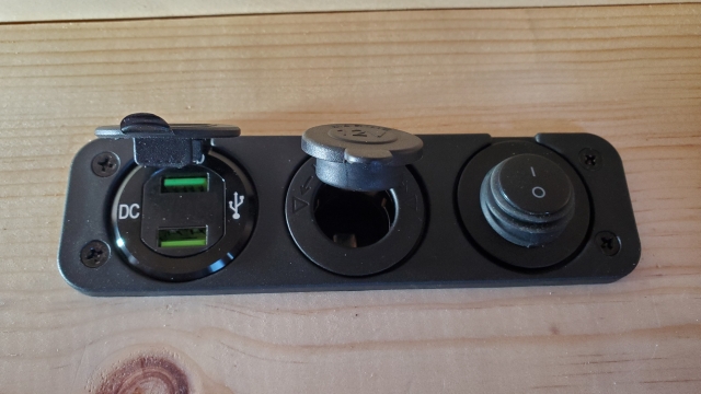

Postby philpom » Mon Dec 12, 2022 2:41 pm
I wouldn't use an outlet like that and would opt for something like the photo below. Converting from DC to AC creates a loss of energy and then you are converting again from AC to DC for the USB port. More loss. The panel below runs straight DC. This along with a 12 volt adapter for the laptop will help extend your battery power life between charges.
The 1 AC port I have can operate using shore power, generator power or battery inverter power making it very flexible while leaving everything else 12v DC to easily support battery only operation.

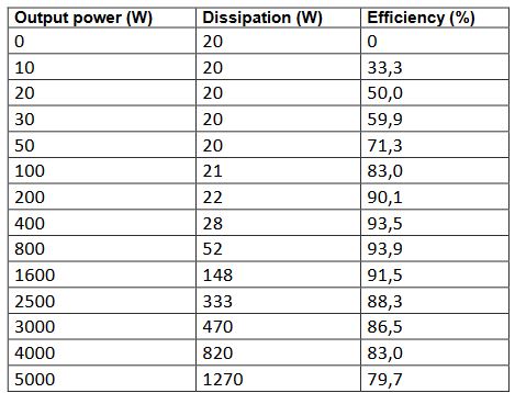

Postby bdosborn » Sat Dec 17, 2022 5:47 pm
tony.latham wrote: I still think you lose about 20% on both. Or am I wrong?
Nope, you're spot on. A good inverter like my Victron Compact 2000 uses 12W just turned on and doing nothing. That's on top of the efficiency losses of inverting 12v DC to 120V AC. Its about 88-90% efficient when it's running partially loaded (like a laptop load would represent). Here's an efficiency table from Victron, one of the few companies that publishes detailed inverter efficiency.
Victron White Paper on inverter efficiency
The black box converters for laptops are notoriously inefficient. So I'd say 20% loss to go from 12V to 120V to 12V is generous, it's probably lower than that. The USB plugs integral with the 120V plugs add yet another efficiency loss on top everything else. Inverter efficiency is directly proportional to price so caveat emptor. I don't use any 120V in the trailer, everything (including my wife's CPAP) runs off 12V DC. I splurged in the van and added a largish inverter. Watching how much real life power it uses has been eye opening.
