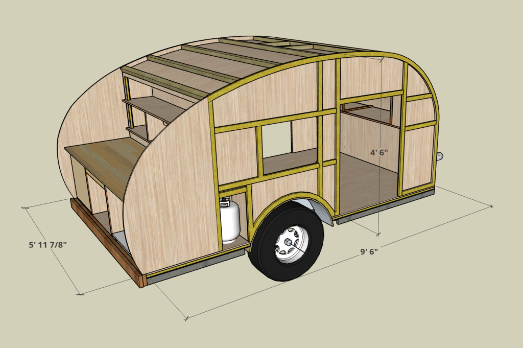

It's on the larger side as am I, (6'-5") Holds a queen bed in length with a little squeeze at the wheel wells.
T4 - Dimentions.png (491.77 KiB) Viewed 1060 times
Looking at it I am not sure what we were thinking with the galley lights. That was planned so many months ago. My wife is coming to my desk now to help get this figured out. Thanks as always! 8)

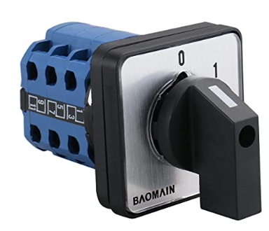

The charge selector will isolate the vehicle from the trailer. At least that is what I planned. Position 0 on the switch turns off all charging sources. with that and the battery disconnect. I think the batteries both vehicle and trailer will be safe. Does that make sense? I am starting off with a 75Ah AGM with the ability to add a second, in parallel when it's in the budget or a rich uncle dies. ;)

Postby featherliteCT1 » Mon Jan 30, 2023 7:33 pm
I do not think that that Baomain switch is DC rated. That could be a safety problem if the switch is ever operated under load.

featherliteCT1 wrote:I do not think that that Baomain switch is DC rated. That could be a safety problem if the switch is ever operated under load.
Thank you. I will check into that. One of the features I liked about it was that it had dual poles for each position. Meaning I would disconnect both sides of the circuit at the same time. Such as, disconnect the solar panels from the solar controller while disconnecting the solar controller from the battery which is a requirement of the solar controller. (I think that made sense!) :roll:

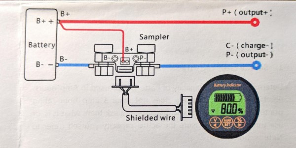

Onajourney wrote:4. Double check you shunt monitor. Most monitor the negative side and your drawing shows it on the positive.
Here is the wiring diagram from the installation instructions. It shows it in series with the negative pole.
shunt wiring.jpg (44.04 KiB) Viewed 950 times
Onajourney wrote:5. That Baomain switch should be rated to 20A and is good for either AC or DC currents.
I agree, I double checked it and it is rated for 20A at 240v

Postby featherliteCT1 » Tue Jan 31, 2023 4:54 pm
How do we know the switch is DC rated?
