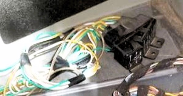

The previous owner (next-door neighbor) of my '01 BMW X5 E53 3.0i "project car" (my final one, after 58 years of tinkering automotively) bought/reconstructed/renewed/rebuilt just about every system on the vehicle, for 3.5 years, specifically in preparation for trading it to me, for my '66 Chevelle drag race car (that had been sitting, unused, in my garage for 13.5 years, after I quit racing). Among other mods he'd made, to get it ready for me, was adding an aftermarket hitch and a strange homemade 4-way trailer wiring harness. It has three relays wired into it, which I don't know the reason for, but it seems to work; he tested it pulling his race-bike to races, pulling a 4.5'x 10' utility trailer (also traded, for my 18' car-hauler), and it worked.He's an electrical engineer (so of course it should), but he moved away and has gone incommunicado, so I can't probe his reasons for the relays.
3 relay problem.JPG (47 KiB) Viewed 3331 times

I still would like to know what the three relays do, anyhow.
